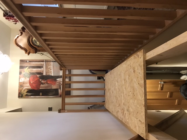

The decorator method would be a ladder from the stairs padded up agaisnt the hand rail, then a scaff board back to the stair head onto the 2nd bottom step of a pair of steps.
you forgot the wood noggins either side to stop it moving back and forth as they can slide as you get on them
