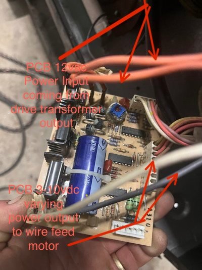

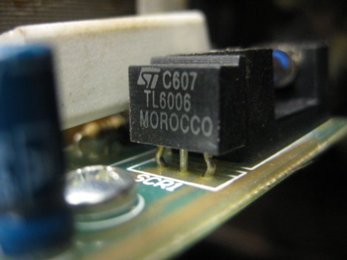

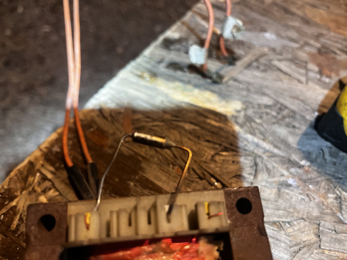

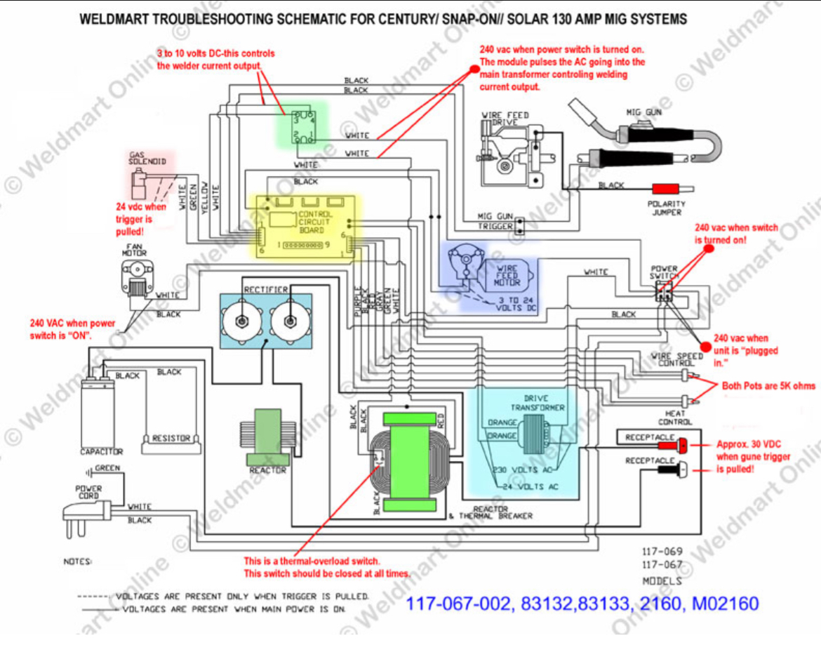

I am dealing with intermittent wire feed issues which has now settled into a consistently not working at all situation in a mactool 230v mig welder which i had running thanks to this forum (main ssr was toast) and then all the sudden the wire feeder kinda would sorta run, stop and then I’d adjust the feed POT and it would slowly start running again and gain rpm then kinda stop and sometimes just start up again, etc.. all the while my gas solenoid and relay are still working with trigger pull and I’m nearly 90% sure my electrode would still arc. I could heard the machine humming and at different levels adjusting the heat control POT while trigger was engaged.The usual failure would be the output transistor.
If you could post a photo of the PCB,maybe someone could suggest a few tests or cheap replacements to try.

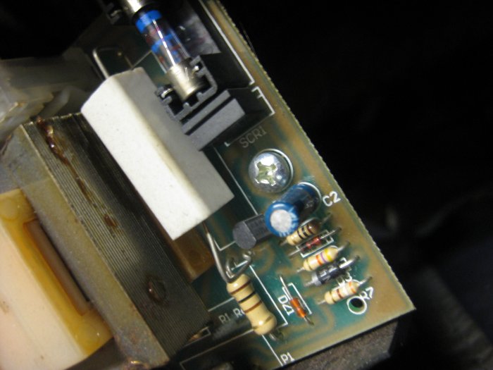

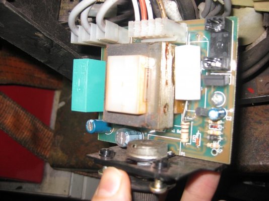

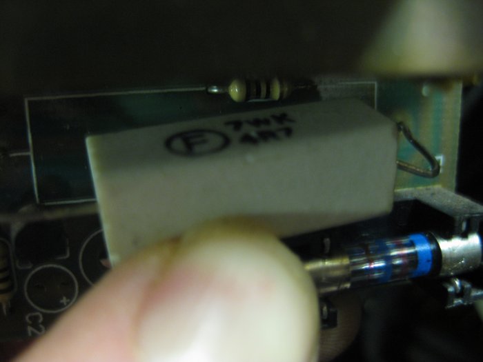

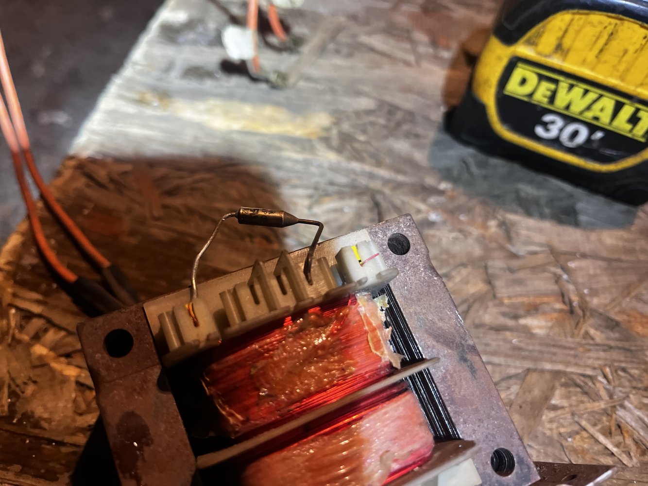

That's an interesting component. I researched it and now think that it is a "Thermal Fuse". If the transformer overheats the fuse will open at a preset temperature ( which may be marked on the component ).I’ve simply removed insulating tape from coil to check coil condition and also pulled out a thermal resistor, or at least that’s what it seems it is to me
