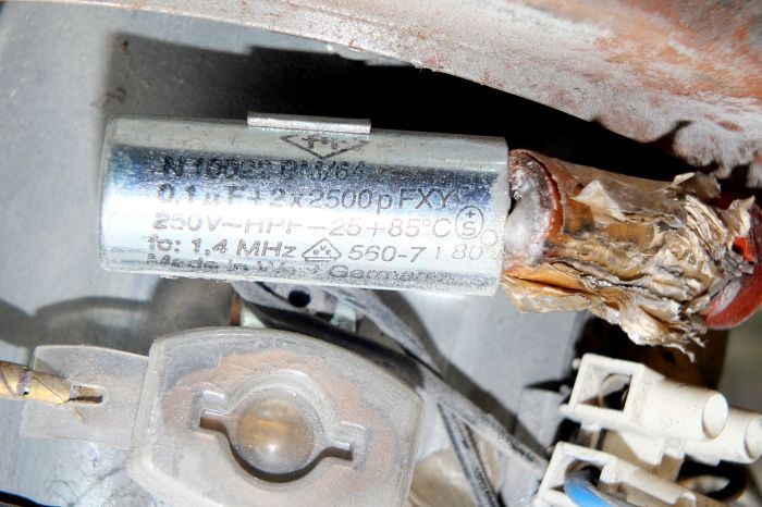

35-year-old Bambi HVLP sprayer stopped with a loud bang, capacitor blown apart.
Casing looks like a bog-standard item (length 40mm, diam 16mm), but I could not see anything of similar rating in Farnell, RS or Maplins websites (most seem to be either much greater capacitance, or else low voltage rating).
N 10022 BM/64
0.1uF + 2 x 2500pF XY
250V~HPF -25 +85C
Is there likely to be any modestly-priced item that I could fit instead, or should the whole machine go to the dump? Don’t want to spend very much, in case there is some other fault in the motor.
N 10022 BM/64
250V~HPF -25 +85C
There are three capacitors in a delta configuration.
