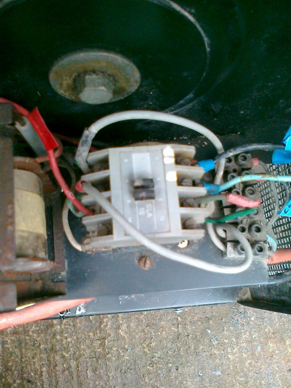

My Cebora 130 was working fine and part way through making up a tool just stopped. It still has power, the wire feed operates when the trigger operated, the transformer note changes when the power setting switches are flicked but no arc. When I stripped things down it is obvious that the contactor is not energising and when the button on the side is pressed things burst into life. I have checked the relay on the control board is operating correctly (even the delayed release operates).

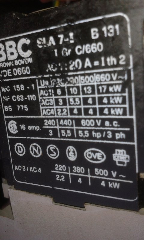

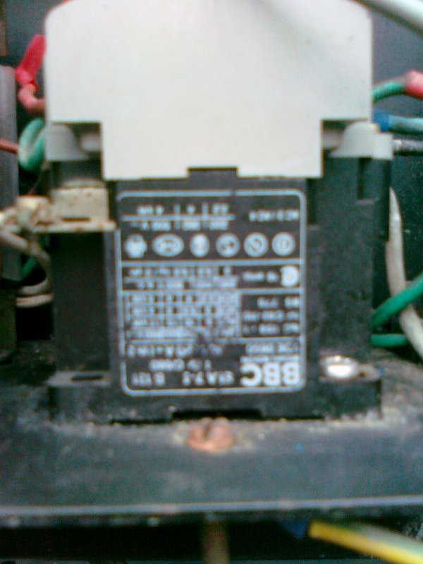

- What is the triggers for the contactor, a DC voltage; if so what voltage?
- Any advice on testing the contactor, can I activate it with an external supply; if so what voltage?
- What is the correct output from the control board to the contactor?
