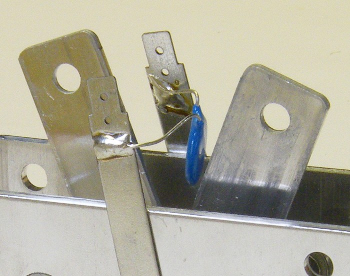

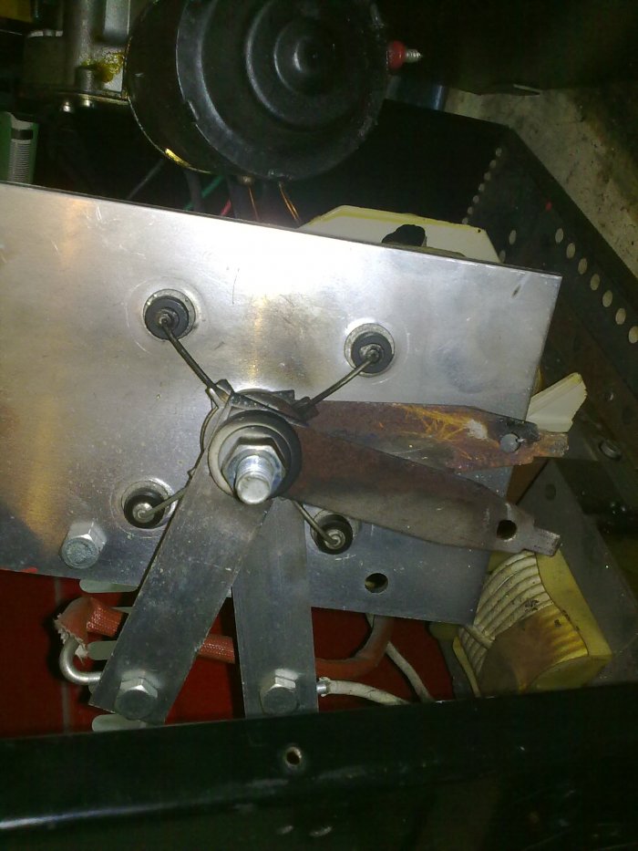

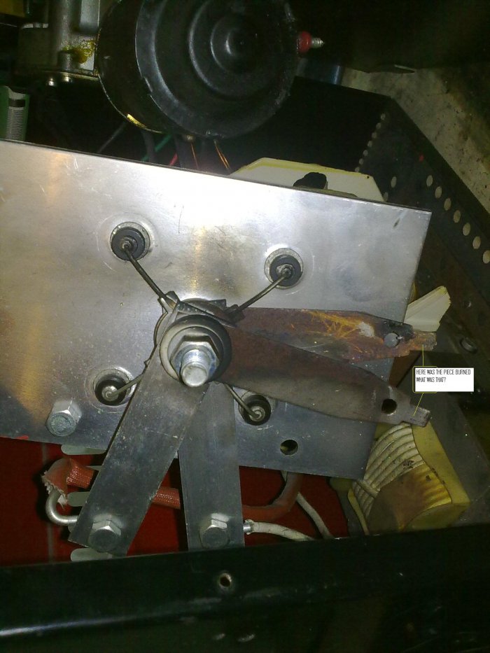

MOV are over voltage suppressors .Probably the little blue part in the photo has failed - there is nothing else in the rectifier normally in that position. The blue part in the photo of my rectifier is numbered "hel 14d680k". Google says it is a varister also known as a MOV. I have no idea what it does but eddie49 is right.
