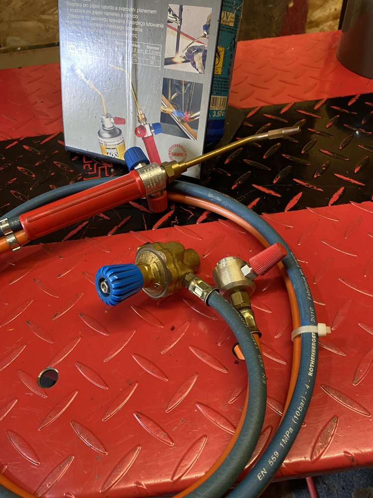

My old Roxy Plus brazing / weld kit is playing up, the control knobs have become notchy and the O2 does not turn on now, I've a few bottles of O2 and lots of gas so want to keep it going..
Rothenberger won't service it, and didn't seem to have a parts diagram for it which I thought odd.
There's an o ring that has perished where the reg locates onto the o2 bottle so I need to sort that.
But questions are is there any lube that should be used or should it all be bone dry?
Also, anyone know where I can get a parts diag for this set?
Many cheers
Edit - I've read that lube is a big no, so will dismantle and see why the knobs have become bad and why the o2 is not turning on.
If anyone can help with a parts diag that would be appreciated.

had been over tightening shutting off, and as the plastic knobs act on the brass squared valves I had pretty much deformed everyone so they were just spinning or hardly catching.. built the plastic knobs back up with JB and needle filled square.
