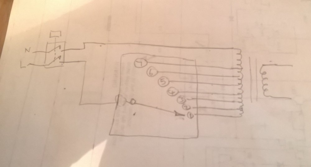

Right guys, the other day i picked up an old welder, its made by a company called awelco and its a standard power 185, also sold as a kamanchi platinum 185. i bought it as a non working unit and it looks like ther guy has had a go at fixing it but some of the wires from the transformer to the switch were loose inside, ive found the original problem to be either the small relay on the low voltage side or the thermal switch (not allowing the relay to close) so ive sorted that problem temporarily by manually closing the contacts on the relay and everything works as it should now but as soon as you pull the trigger on the gun it trips the electric, which i assume is because the switch is wired up wrong because when i hook up the primary winding to the contactor essientially bypassing the switch it welds fine but is stuck on its lowest setting because you cant operate the switch. Now theres 8 settings on the welder and 8 wires coming from transformer, the longer one goes to the neutral on the contactor then the other 7 go into the switch and there should be a live coming from the contactor to the switch but this wire was loose and i cant figure out where it should go on the switch, the switch is numbered 1, 2, 3, 4, 5, 9, 10 there some un numbered contacts on the switch but have jumpers on them, numbers 5 and 10 also have jumpers connecting them to 2 other terminals, i am completely baffled as to how this switch works or how to even test it with a multimeter so was hoping that someone on here could give me a bit of advise or better yet if anyone has one of these welders if you could show me what goes where?
