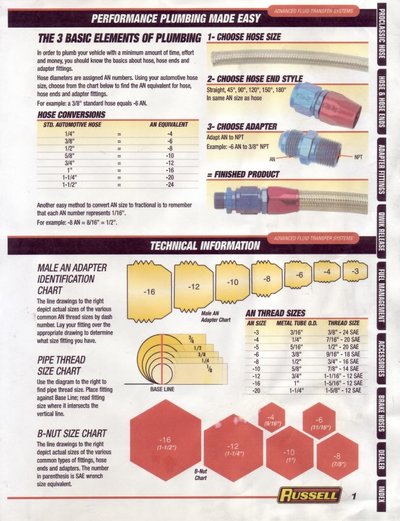

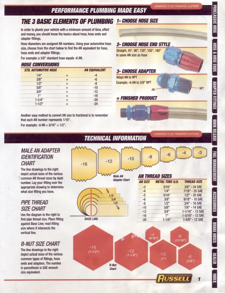

Im trying to get a weld on aluminium fitting for my fuel tank, now -an fittings always confuse me.
I need to come off the tank with a elbow then to 6mm ID braided rubber fuel hose, so what fittings do I need ? An-6 or An-4?
EBay links would be useful as I need to order these asap, cheers all.
