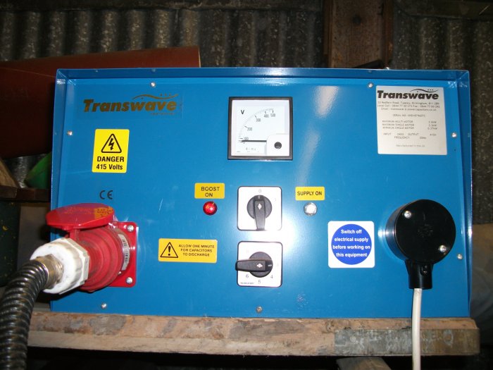

boosts the start and 1 2 and 3 will be the voltage regulator. once the motors started turn the switch till it sounds nice running
I was hoping you would see this
So what setting would you start for a 3hp motor, say start on 1 and then switch to 2 or 3 or start on 3 and then go down ???
My mate saw it working but didn't think of asking how to start it
So to turn off do i just use the 240v switch ???
it could either be a 1.10kw or a 1.50 kw. either a one and a half hp or a two hp motorNot sure it can run a 3hp motor. Output says 1.?? kW. A 3hp motor is 2.25kW. suppose if you don't load it too heavily and it keeps the amp draw down you should be O.K.
