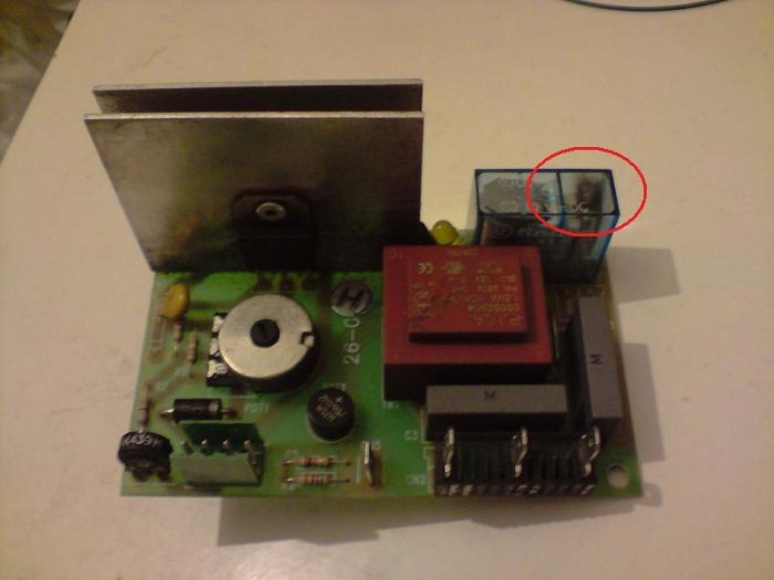

If the round black component has four soldered connections underneath, it is a bridge rectifier. It changes the output of the small square black transformer from AC to DC. If it has only two connections, it may be an electrolytic capacitor, and could be used for smoothing the DC.
