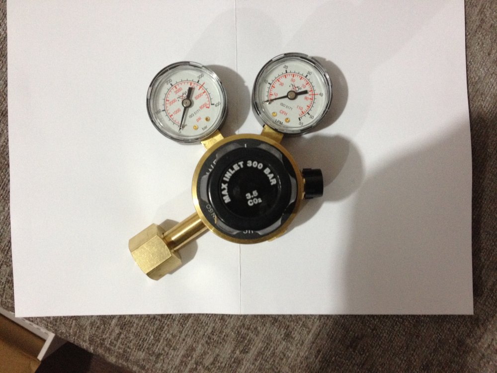

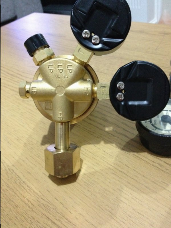

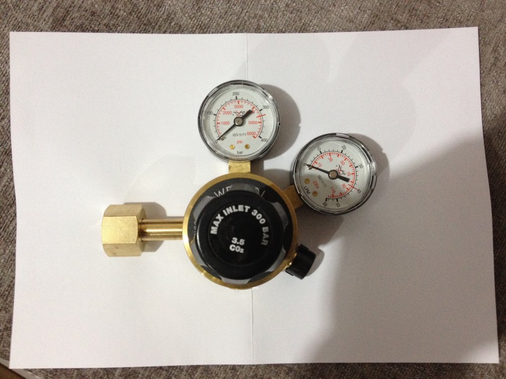

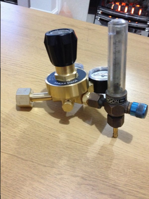

When you look at the back of the new reg the ports are in the right place just seems like the arrangement is wrong, think I will give the weldequip guy a call before I fit this
Wouldnt fit that anyway, the regulator is now out of date. See the marking 03.15 on the back?? March 2015.
If anything happens with that regulator, no insurance company is ever going to cover a miss hap, when talking about 200bar plus bttles of gas of any description without in date regulators being used.
Especially considering that if there was a complete discharge from the cylinder due to a fault, or something hitting the bottle and somebody is in the firing line, it most probably WILL take their head clean off their shoulders
Not nit picking, just a note worth making :thumbs up:
it needs replacing in 4 years then
