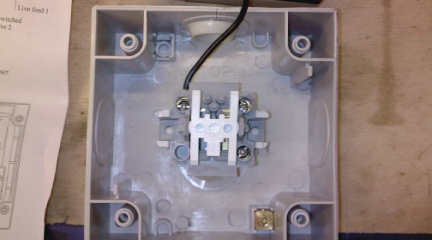

hi mk wonder if you could help me with this problem just bought an outdoor ip66 weatherproof socket and theres 3 conections in the box its for an outdoor light trouble is for some reason theres no markings on the terminals wonder if you could give me some pointers thanks ian
thats a two way switch one terminal will be common, then you have two switch terminals. use a multimeter to find out which is which. Try the one on left as common first failing that the bottom one
