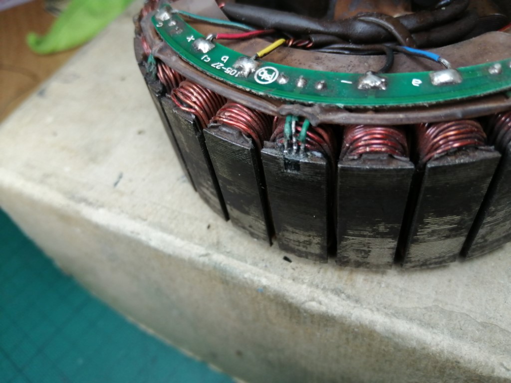

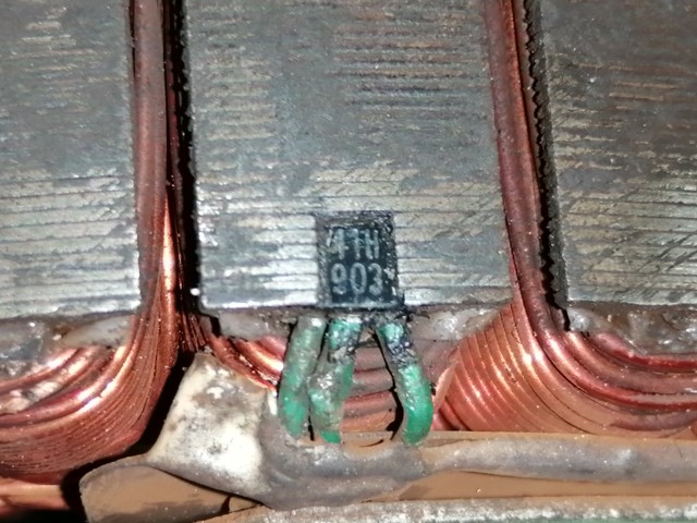

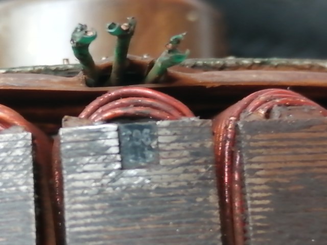

I'm trying to help a guy at work. He has a e-bike he uses for travelling to and from work that's suffered a collapsed bearing. A piece of the bearing cage has torn the legs off one of the hall-effect sensors so now he has no drive to the wheel. Replacement wheels are out of stock so I want to replace the sensor itself.
I'm going to attempt to scrape away enough potting to get a fine solder joint onto the sensor but if that fails I will replace the sensor. Trouble is I can't find the exact one but I am sure that any of several types would do if only I knew a bit about electronics.
So, just in case I mess up the solder repair can anyone suggest a compatible replacement for the sensor shown in the pics below?
Cheers for any suggestions
