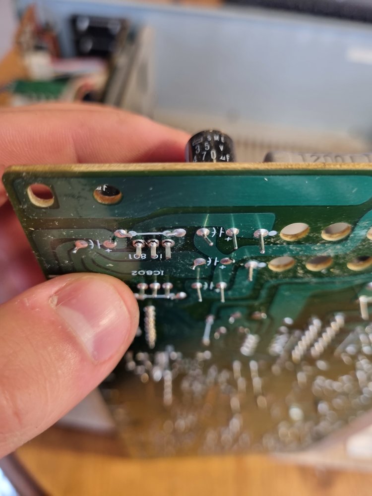

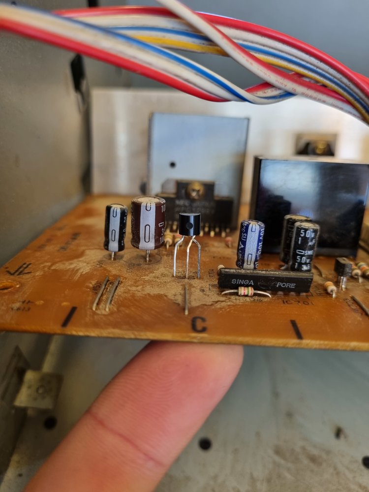

C705 is fine, Q704's collector is at +15V but shorting it to the emitter doesn't do anything.
Looking at the diagram, the emitter appears to be connected to ground, but it's sitting at +22V from ground, unless I'm following it wrong? Shorting the collector to ground gets the brief illumination which fades out. The base is at 27V, looks like it's connected to the AC output of the transformer so that's probably about right.
