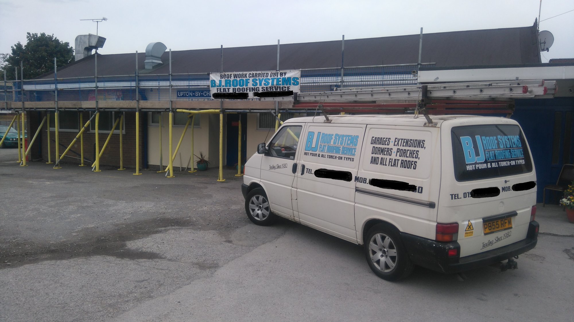

A while ago we had a big repair done on our warehouse roof. It is a typical asbestos sheet roof over a steel frame.
Sadly over our offices it didn't fix the problem.
The work needed doing anyway though.
It turns out the drips are coming through the hook roof bolts then tracking across the steel frame.
The roofers said the bolts will need cutting out and replacing with new washers. The problem is getting them back!
I spoke to another roofer who said that just slapping some acrypol over them would work.
Any ideas? It would make removal later on a nightmare but a cheap fix hopefully.
