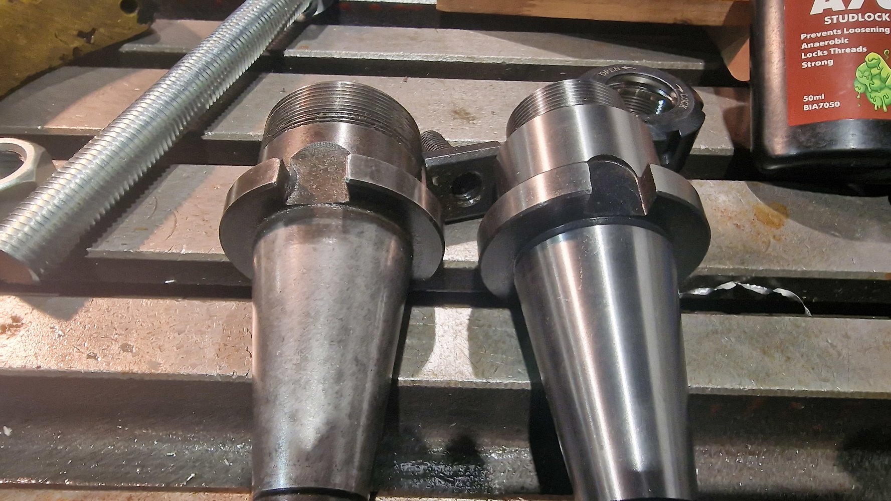

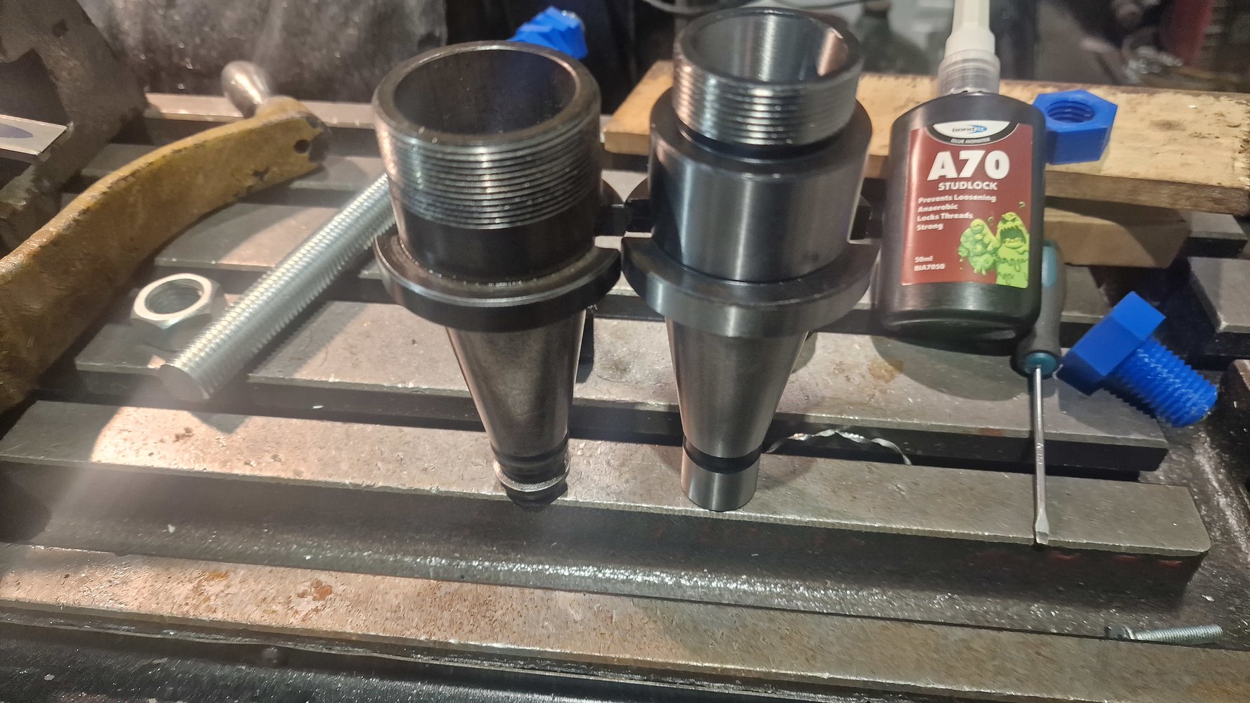

It should be pretty much through-tapped for the drawbar

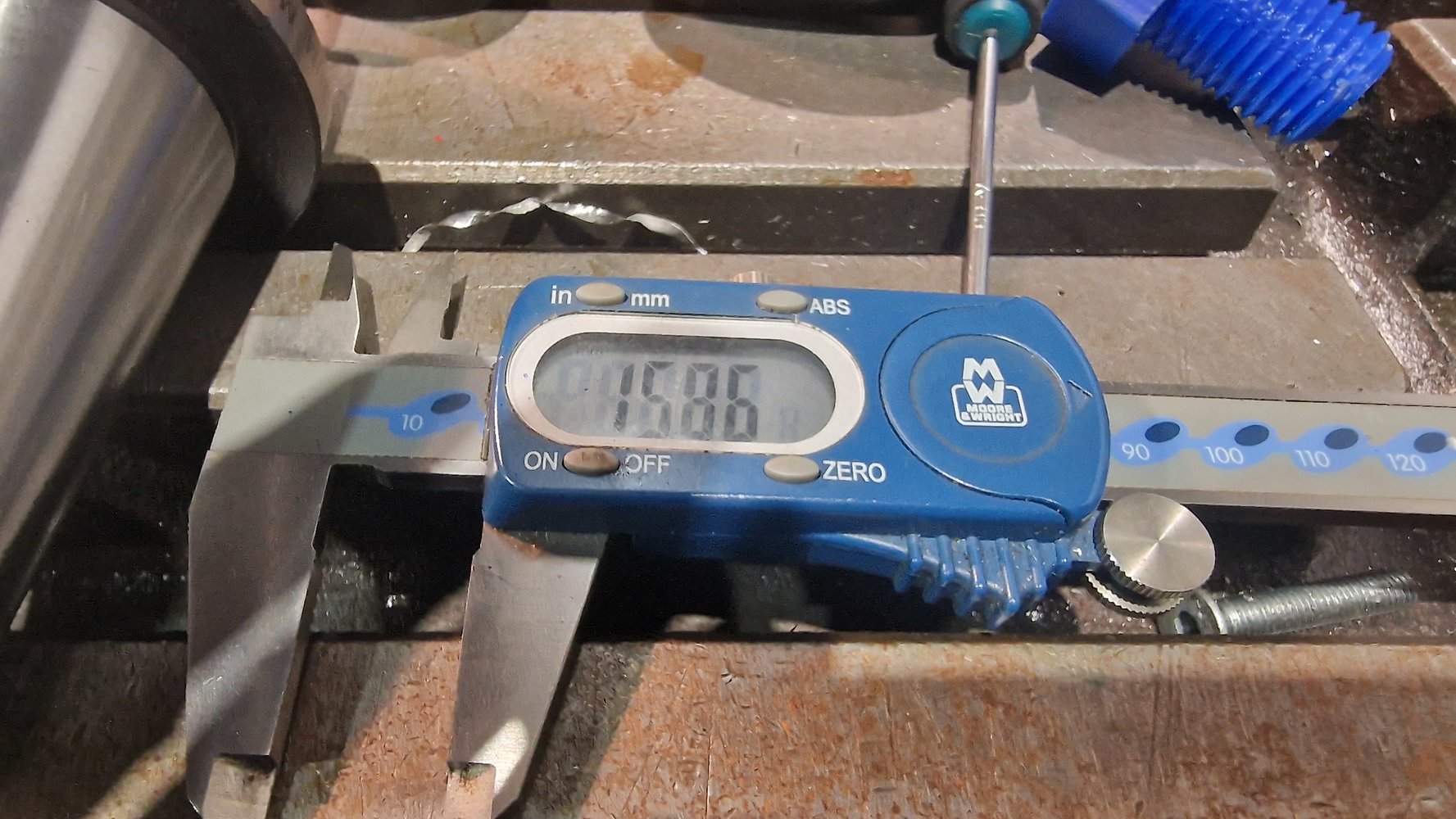

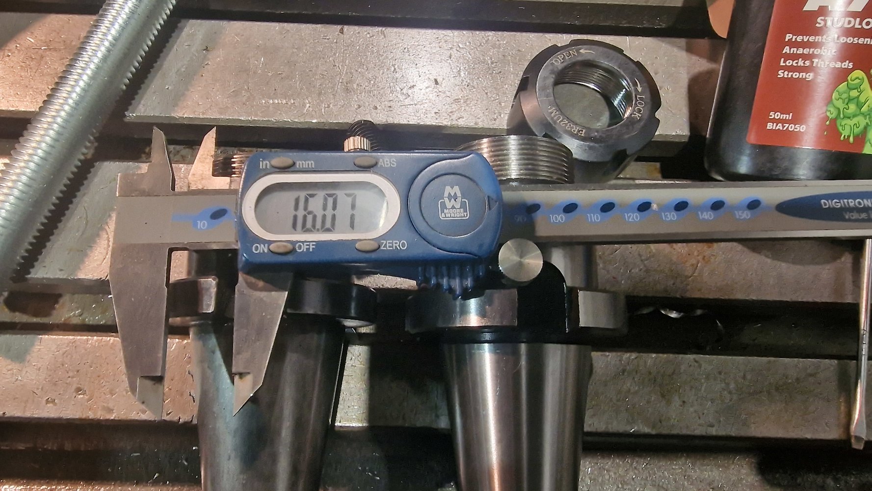

Slot in tool is only 15.85Most of RDG's stuff is sourced from India.
Drive dog on spindle should be 15.9 (b1 dimension): http://www.manufacturinget.org/home/4472-computer-aided-design/lab-assignments/spindle-nose-taper/
Slot in tool should be 16.1 (d6 dimension): https://www.kemmler-shop.de/en/din-69871-iso-7388-1/technical-information/
Does the 14mm diameter tapping drill hole go deep enough? Maybe that is what is stopping the tap itself advancing.
Is the thread too short or your drawbar too long? Normally, 1 x D thread engagement is ample (think of how thick a standard M16 nut is - if that develops full strength, any extra length of engagement is unnecessary).
