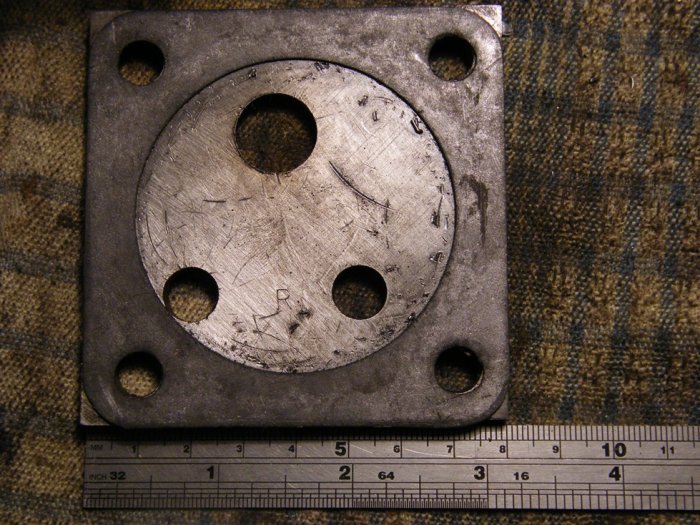

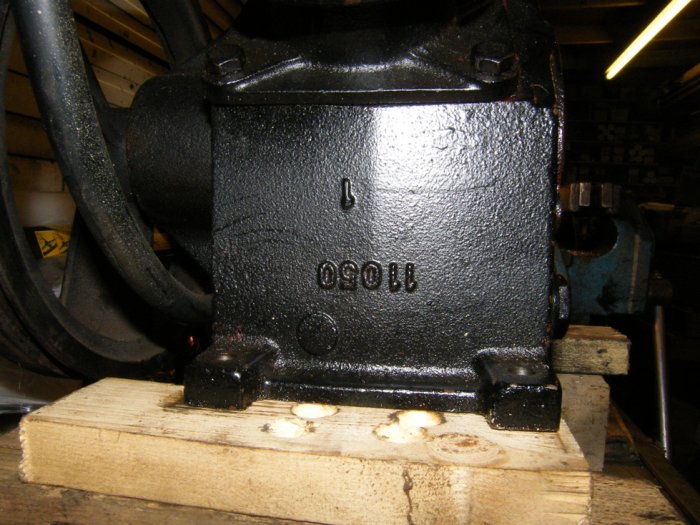

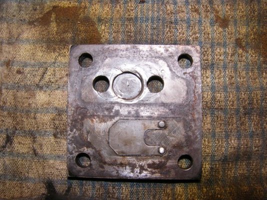

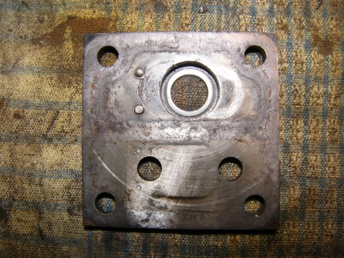

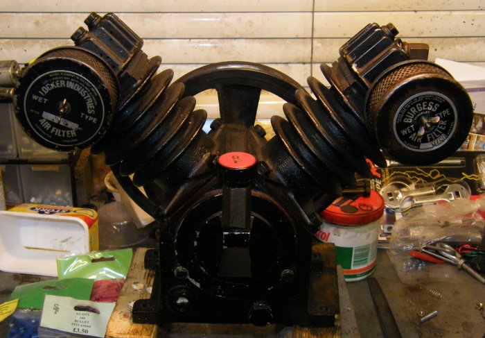

About 3 years ago I bought was sold to me as an Ingresoll Rand compressor (vertical tank). After about 3 months the compressor made a horrible noise, seized the drive belt and stopped!
I dismantled the compressor pump, took some pictures and got in touch with Ingersoll Rand. Then I find out the compressor pump is one they have never heard of or have had any dealings with.
So, I a, looking for some help if possible. The previous owner had obviously had a reed valve fail and had bodged it with a disc and spring. The spring had gone and this is what has jammed. I have made good the hole, but I am looking for the reed valve, or any other (clean) suggestions as to how I can get this working again.
There are a load of pictures below, one of the pump as a whole and some of the broken valve plate and a good valve plate for comparison. Any help is appreciated.
Cheers
Peter
