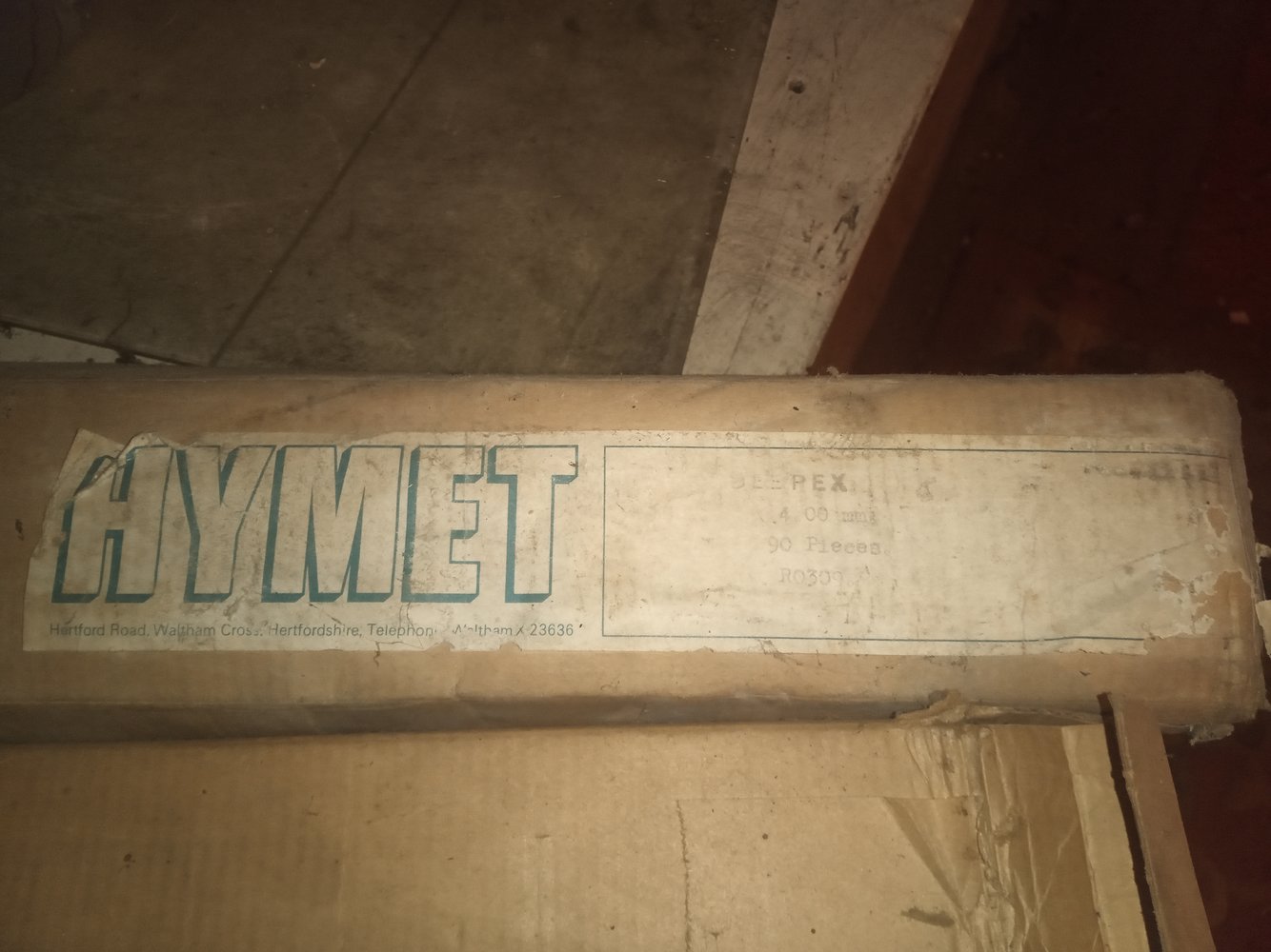

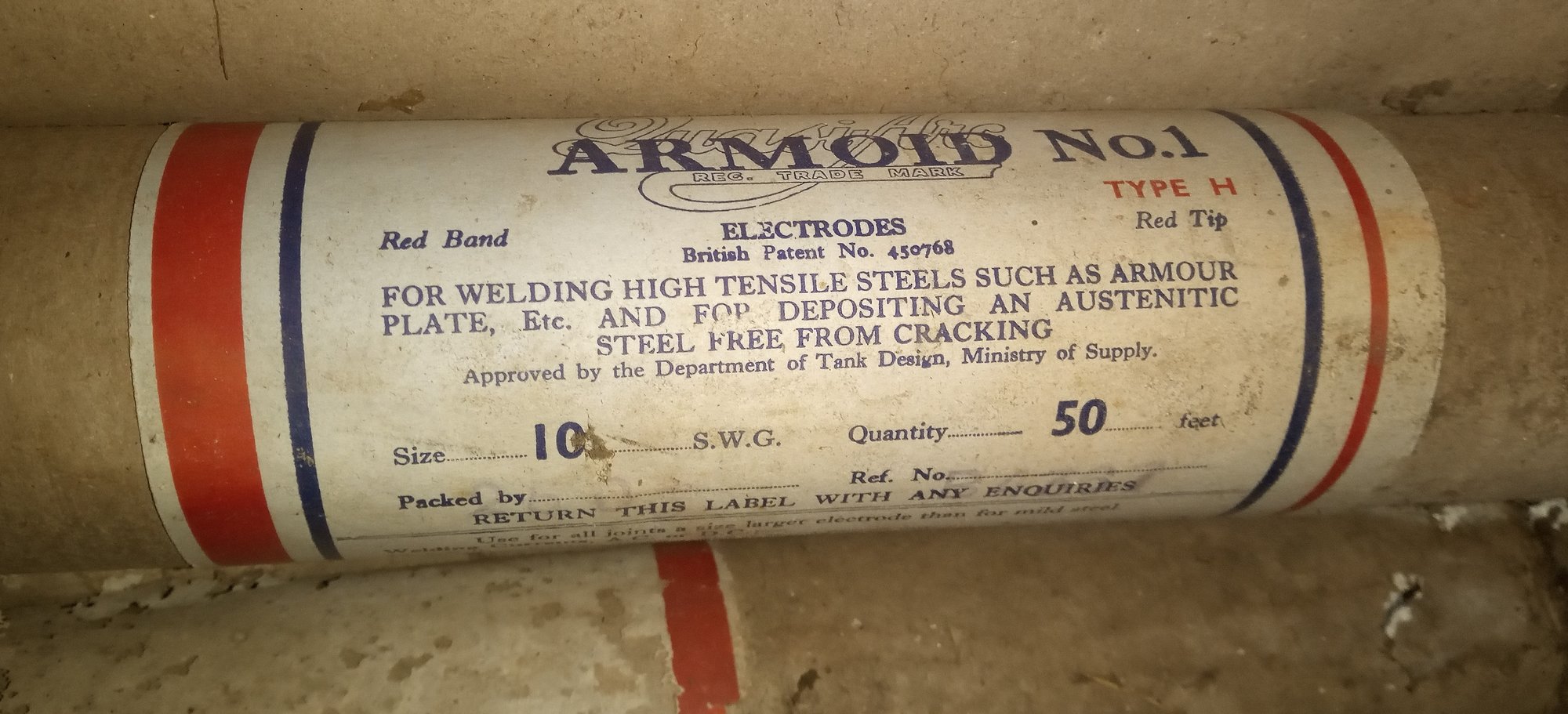

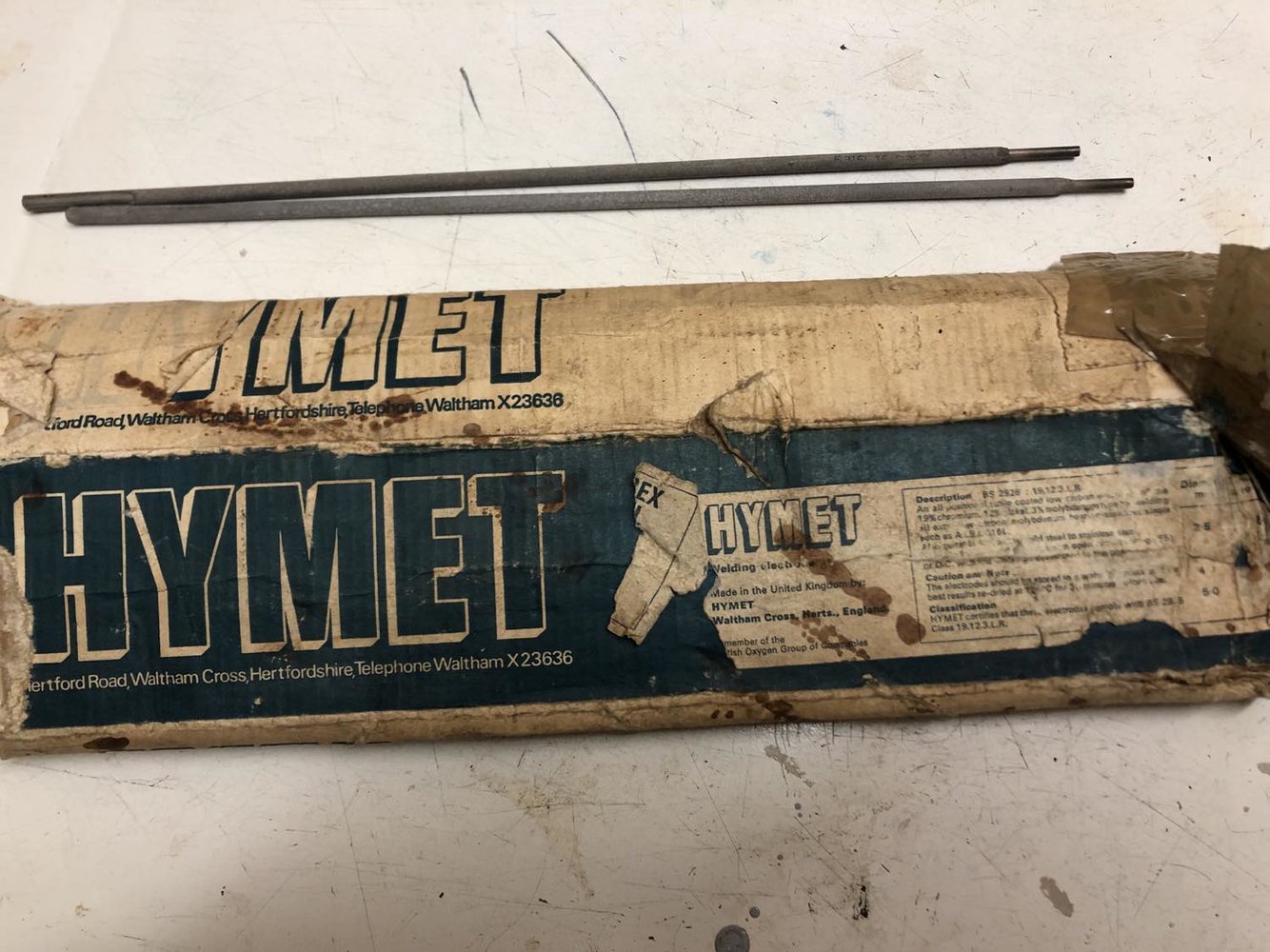

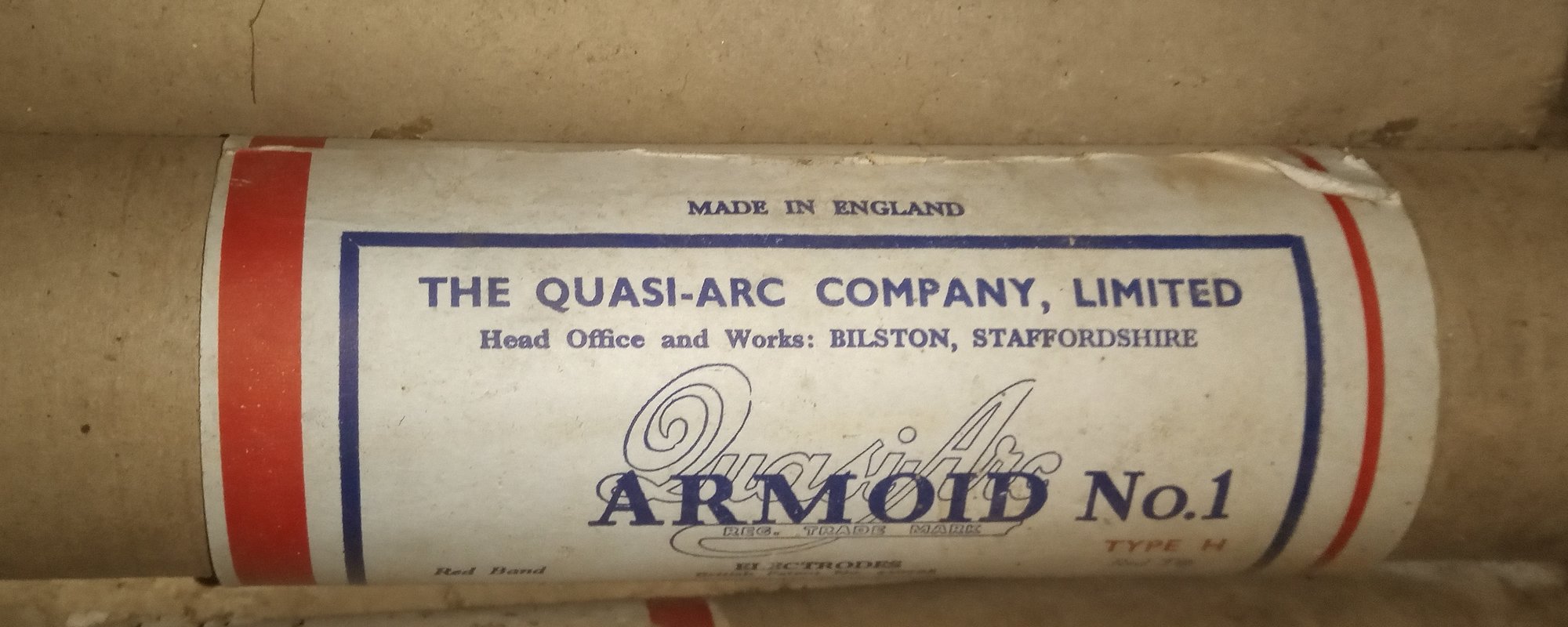

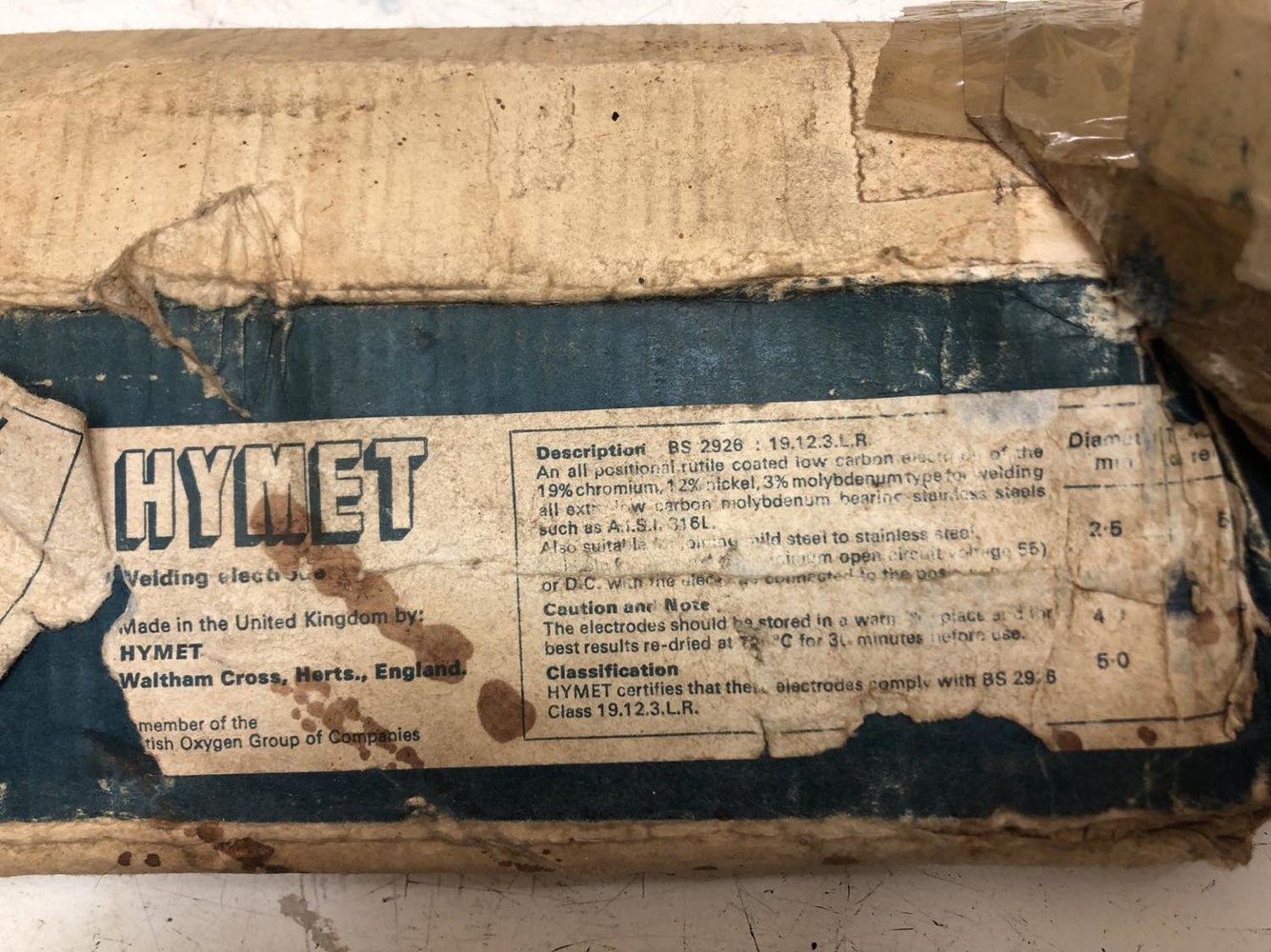

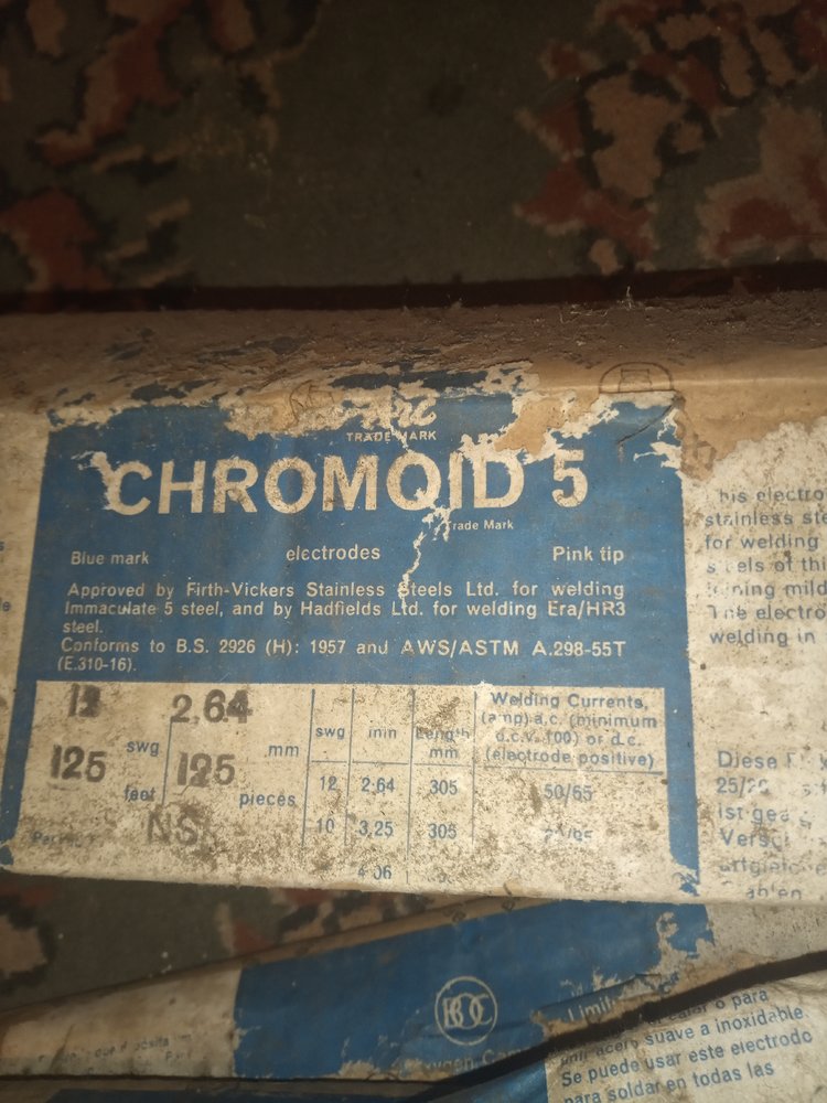

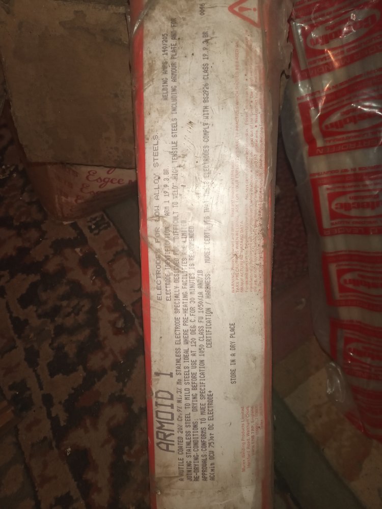

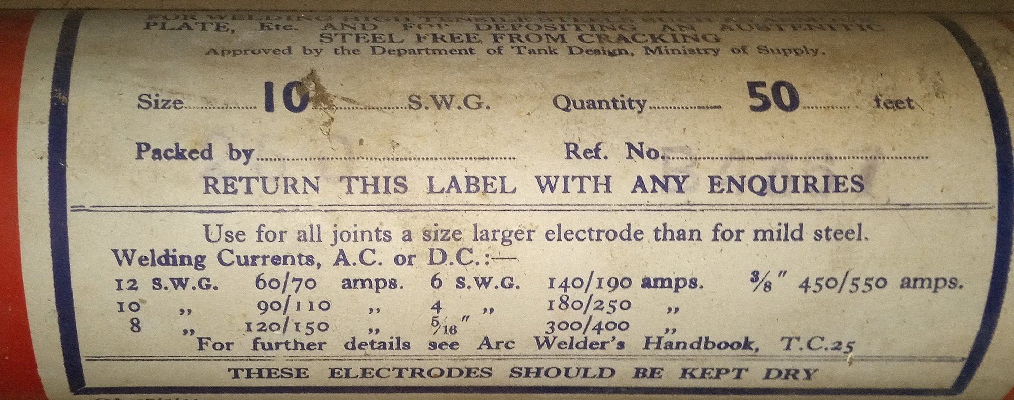

I’m honestly not sure, I’ve never run them before- most repairs I’ve done I’ve used stainless wire/rods due to armox not exactly being on the shelf! If you can spare a box I can give them a tryyeh no problem how many are you after?/ how much weight? thanks
