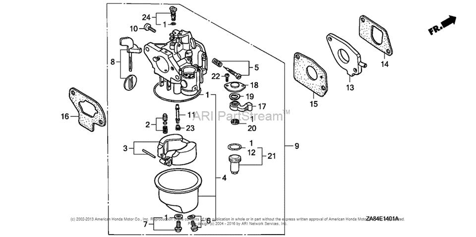

Just the sound gives it away, as said above its hunting. You could also reset the governor to factory setting off the manual, it might have been knocked out of adjustment.
A £3 can of carb cleaner from toolstation to blast out all the carb passages, ultrasound is not always necessary.
