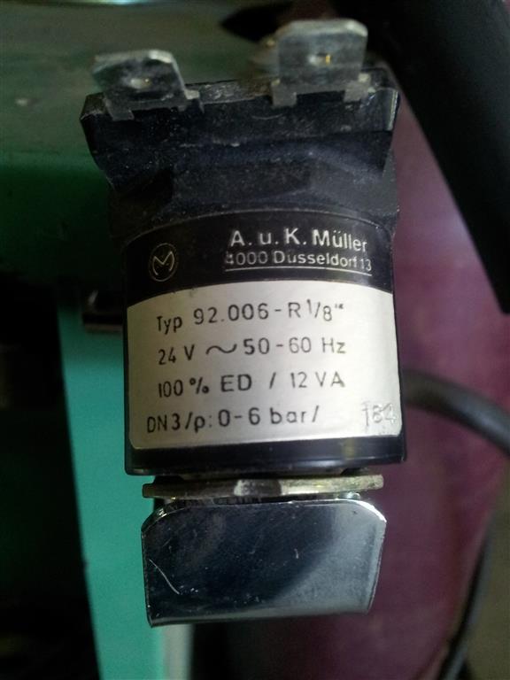

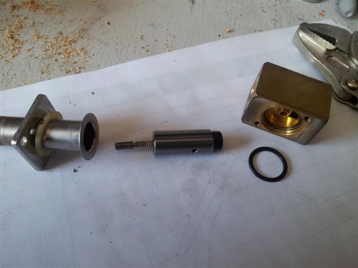

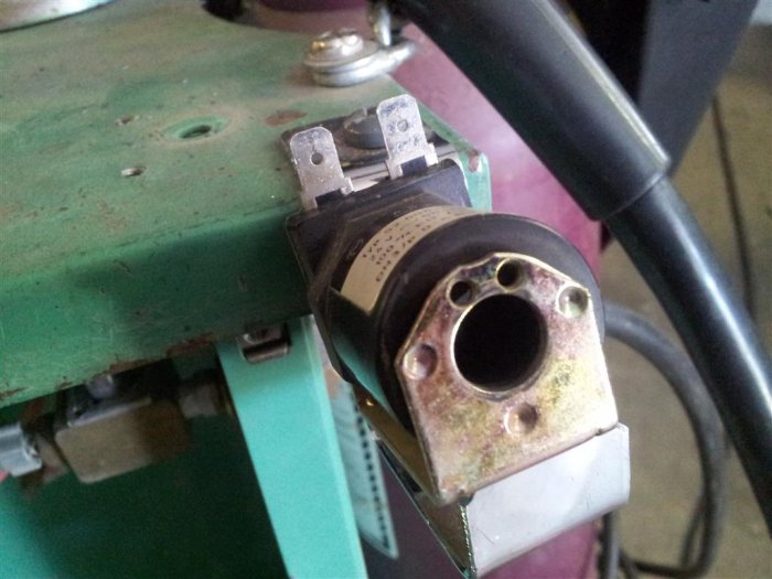

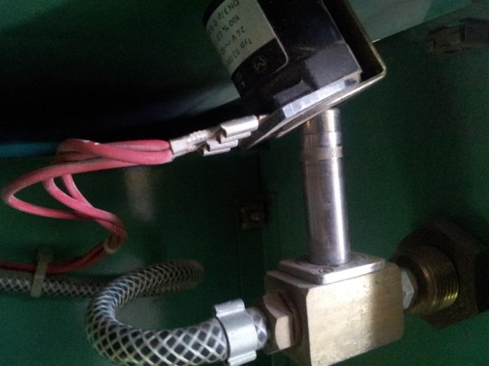

Hey Guys, I need some advice,
I have a used welder that I just picked up, brand name Linde.
It is a mig with argon gas, actually that's the problem. When I turn on the gas bottle, and then I adjust the argon knob that allows the little silver ball to move up thus allowing gas to go through to the torch when the trigger is pulled. It must be malfunctioning because the gas comes out of the torch all the time whether the trigger is pulled or not. The only way to stop it is to turn the little knob off, thus making the little silver ball drop down and cutting out the gas.
My understanding of this equipment is limited, however correct me if I am wrong, but the gas should come on and off when you pull the trigger to start welding?
If I am correct in this assumption, then there must be a malfunction. Can anybody suggest what might be wrong, or a direction to investigate?
