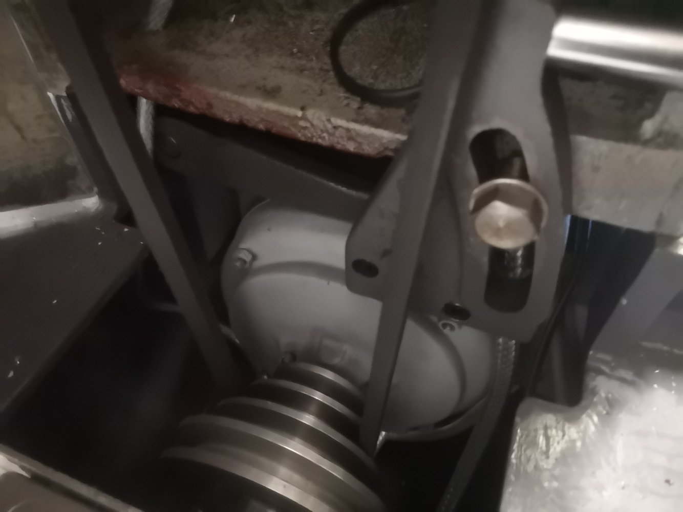

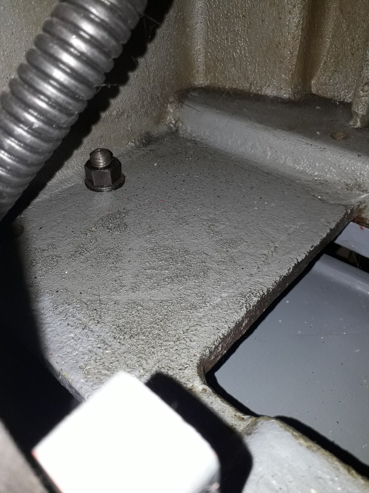

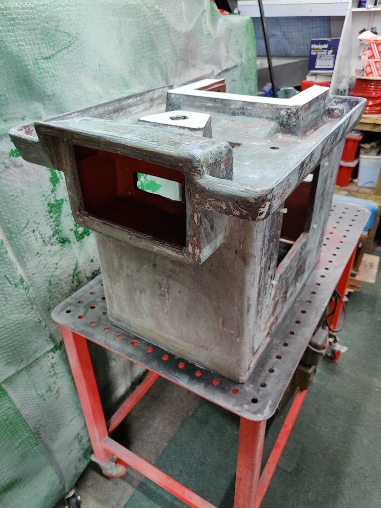

I'm in the process of restoring my Elliott Omnimill back to its former glory. One piece which is missing completely is the horizontal spindle motor. Now I intend to but a replacement motor for it, however I only have a couple of pictures (thanks to @Milkybars! One attached of the mounting plate) of how it mounts up to the base of the column.
I have pictures of the adjuster, but I don't have of the motor mounting plate. It must pivot at one side, to allow for the adjuster to put tension on the belt, but I don't have a good enough picture to see if this is something I could get knocked up.
Can any other omnimill owners help? Do you have any pictures of that area that you could send?
