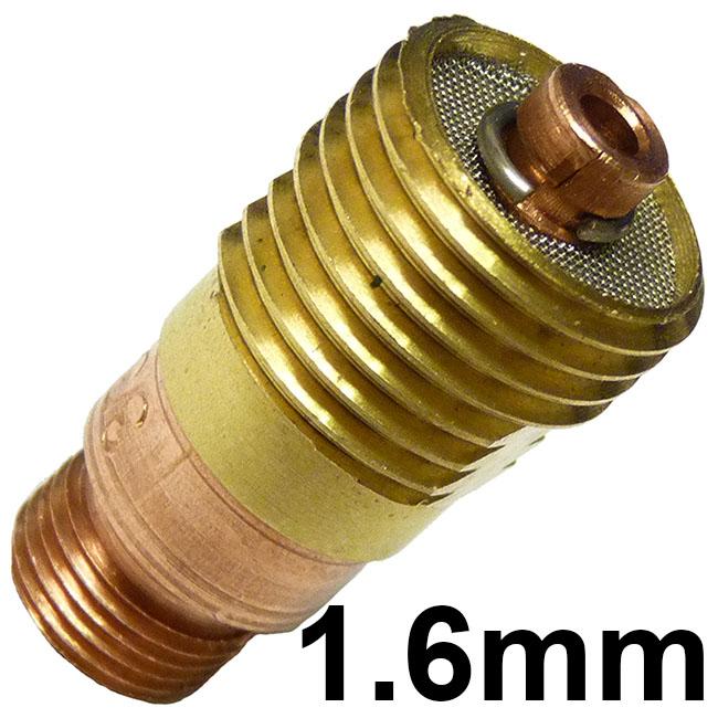

G Gizmo.Y Member Messages 848 Mar 31, 2017 #1 Looking for the fitting on the bottom right. It converts a WP17 Torch so it can use the FUPA #12 Cups. I've bust mine and they are £24 for the "Official" Furick one....

Richard. Member Messages 18,335 Location Cambridgeshire Mar 31, 2017 #2 Does a standard wp9/20 gas lens cup fit on that thread? If it does then I believe that's nothing more than a stubby gas lens. Ck 4GL 116 is 1.6 and CK 4GL 332 is 2.4. Speak with @Jim Davey about them.

Richard. Member Messages 18,335 Location Cambridgeshire Mar 31, 2017 #3 Looks like this. IMG_1451.JPG 72.6 KB · Views: 58
G Gizmo.Y Member Messages 848 Mar 31, 2017 #4 aye, thats it. Lets me use WP9/20 Cups on my WP17. The only difference i see is the recess for the O-Ring.

Richard. Member Messages 18,335 Location Cambridgeshire Mar 31, 2017 #5 You won't need the recess Oring will happily sit in the thread. That's why they charge £24 for it. It's "different " does the same job though.

G Gizmo.Y Member Messages 848 Mar 31, 2017 #6 Ill give it a whirl. i still have the stubby lens from before i got the FUPA.
