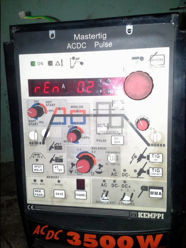

I took a punt on ebay at an iffy looking Kemppi Master tig AC/DC pulse and ended up winning it.
It's grubby and appears the inverter and HF side of things are all ok but it does have one fault: The knob on the font that adjusts the amps and other functions after a button press like pre- and post- ramps doesn't do anything.

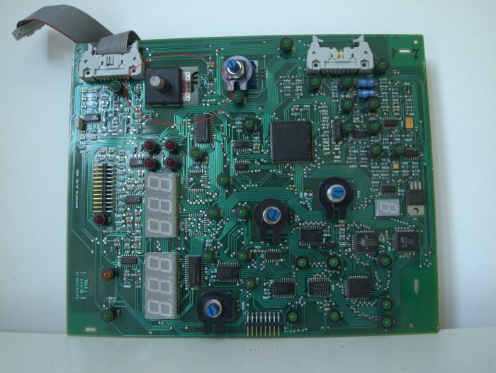

On switch on it's stuck on 50 Amps which I assume is the default, the dial is a rotary encoder rather than a pot. I pulled the panel off and it looks like someone has replaced the encoder in the past, I don't know if this was a failed repair with the wrong part or what.
I'm still checking the obvious things like connectors and continuity, and I have borrowed a 2 channel scope to see what the rotary encoder is doing.
But does anyone have a Kemppi panel they could take a photo of the back of in the area of the Amps dial so I can see if the encoder is the same as the one on mine.
If all else fails does can anyone recommend someone in the Essex area that could take a look at it that wont just go straight for the new panel option, i.e. might be able to chase the fault down and replace the component on the board.
