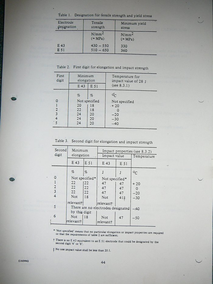

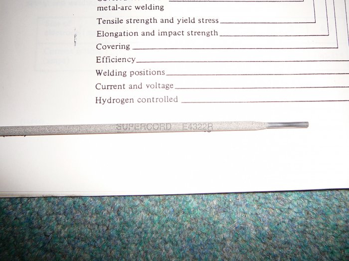

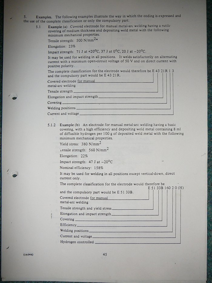

Note: When the fourth (or last) digit is 0, the type of coating and current to be used is determined by the third digit.
Digit Coating Current
0 * *
1 Cellulose potassium ac, dcrp, dcsp
2 Titania sodium ac, dcsp
3 Titania sodium ac, dcrp, dcsp
4 Iron powder titania ac, dcrp, dcsp
5 Lo-hydrogen sodium dcrp
6 Lo-hydrogen potassium ac, dcrp
7 Iron powder iron oxide ac, dcrp, dcsp
8 Iron powder lo-hydrogen ac, dcrp, dcsp
Going by the chart you can use the 6013 either way. the last digit is supposed to tell you which way if the less digit is zero then you use the second last digit
