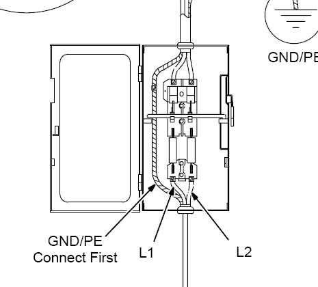

The manual obviously has the wrong picture.What makes you think that Shenion? I see L1 and L2 which I assume would be the live and neutral or any 2 phases. That's the same setup as my Miller Dialarc and my Portamig.
I also see you can change the polarity for gas or gasless operation, maybe that could be the problem?
	All the Integra models are shown as 3 phase.would you say the 343 would work on single phase as i can get one of those ????? also did not understand last message

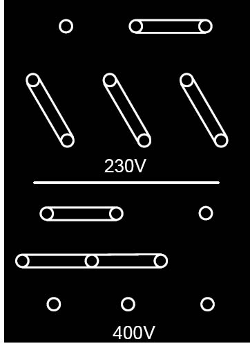

If jumpered for 440V use any two phases.Sorry to butt in, but regarding the dialarc comments, if running on 415V 3 phase supply, I should connect the earth to ground, and L1 and L2 to any two phases? Or L1 and L2 to 1 phase and 1 neutral?
Cheers, Al.
If jumpered for 220V, use one phase and neutral.
