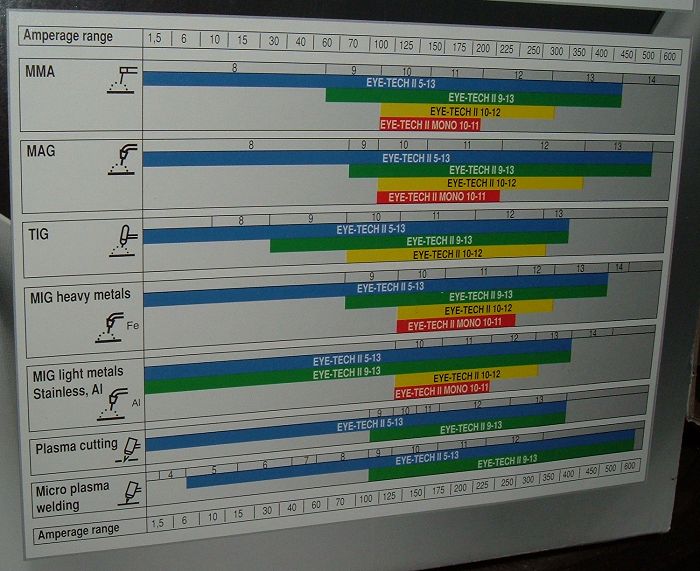

Hi again.
Just wondering if there are recommended strengths of helmet/visor glass for differnet types of welding. I have had the same helmet for going on 15 years and use it for mig and arc. Would I be better off getting a specific helmet for each jobbie?
I have looked at the auto helmets and nearly went for one but I am not convinced that they are safe. Silly I know as they are an established thing, but I just cant shake the doubt. The reaction time, however small "must" be letting a flash though to the eyes somehow even if we cant see it!
Someone shoot my theory down pleasssse!
