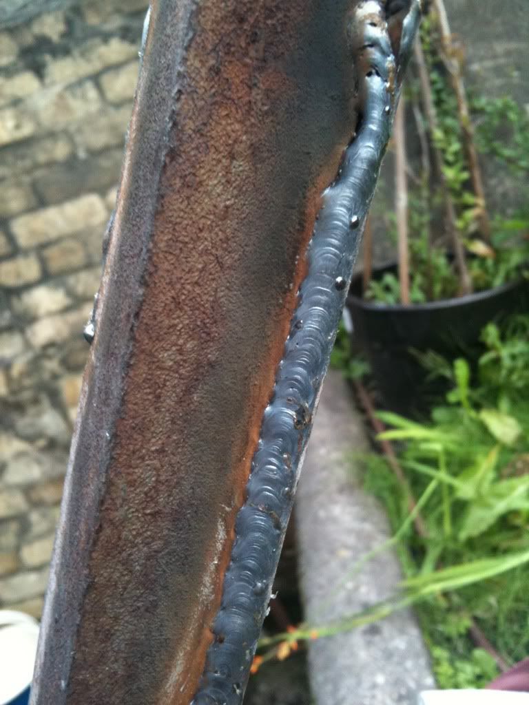

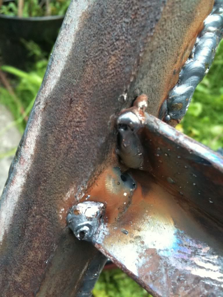

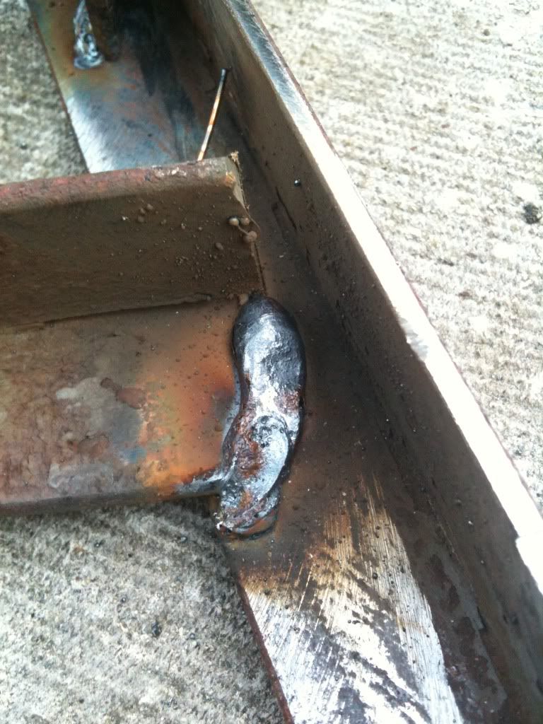

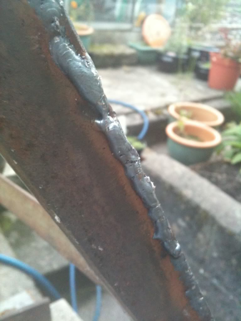

Hi Guys,
New to the forum so i figured i would say hi and ask for some advice as well
i own a mig welder think its one of those models that everyone brands as there own and sells on. (ferm 150/1 mig gas welder). apparently this was sold at screwfix.co.uk for a while.
so i figured i would give it a shot and see what i could do with it as a friend of mine is hoping i can get good enough to-do some welding for him.
it was a bit of a mixed beginning, i started off without the gas on, and could not work out what was going on and wrong, eventually worked out the gas was'nt on and got that sorted, sometimes i weld really well, and then others are really raised off the piece or really "bubbly" (see the top of the last pic for an example), also the wire tip on my welder always has a ball left on it, is this normal?
there are 4 settings on the welder for power and i am using number 3 (seemed to weld the easiest after experimenting with the switches during welds) which seems to weld 5 / 6 mm steel (i cannot break apart any of the pieces i had welded so far).
heres some pics for you all to have a look at and pick apart, as its proberbly the only way i will work out if its good or bad welding and what i can do to improve.
im using 0.8mm wire and tip, with an argon / co2 mix gas. wire speed is set to 4 on a scale of 1 - 10 and the gas was turned fully open (did not realise and now have no gas left
