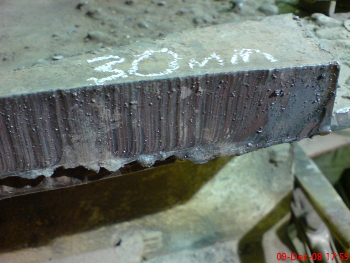

We were cutting some 200x100mm packers out of 30mm plate tonight/lastnight. We had a 120 Amp 3ph machine with a pretty slow travel. Nice cut though, will have to try something a bit thicker to see what it can handle.
