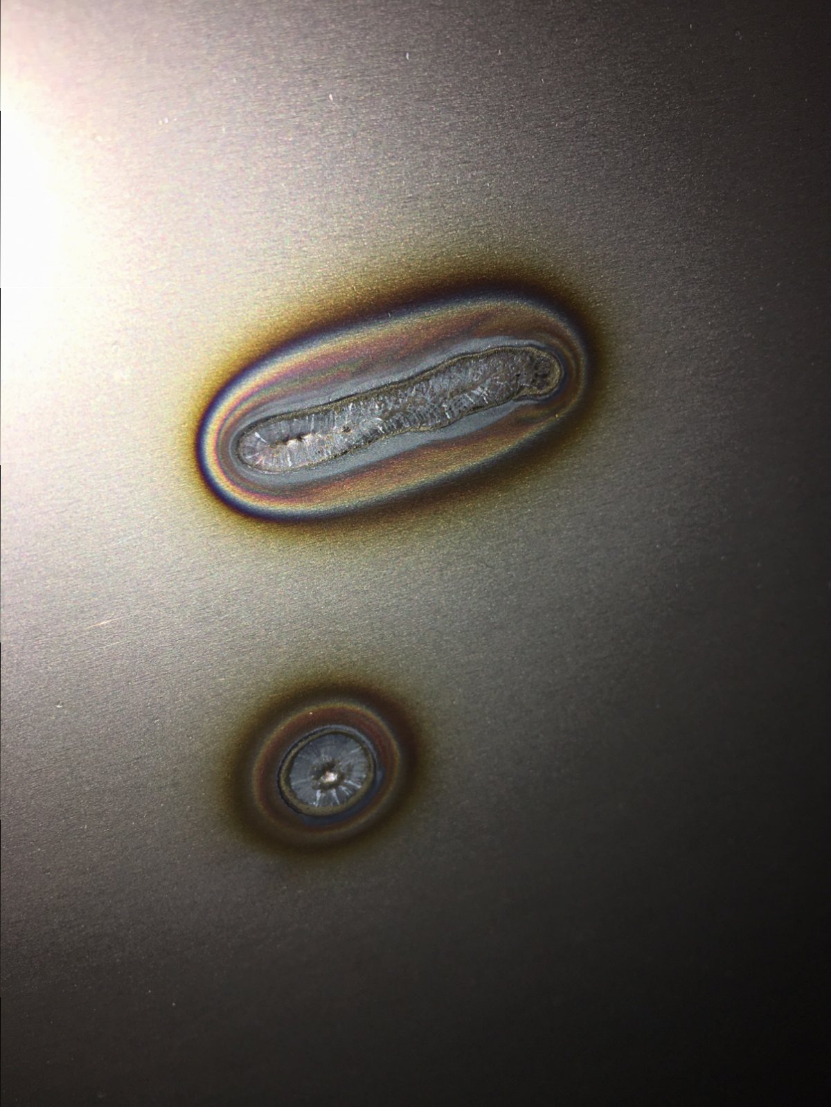

I tried to weld some 304L stainless using 316L rod and really struggled, the welds just looked sugared like I'd have expected the unshielded underside to look, using no filler gave the same result. Awful.
I've even tried just lighting up on new material without any intention of welding it and the resulting circle looks grey in the centre. Mild steel seems to have similar results though lack of knowledge means I can't really tell if the results I get are good, bad or indifferent.

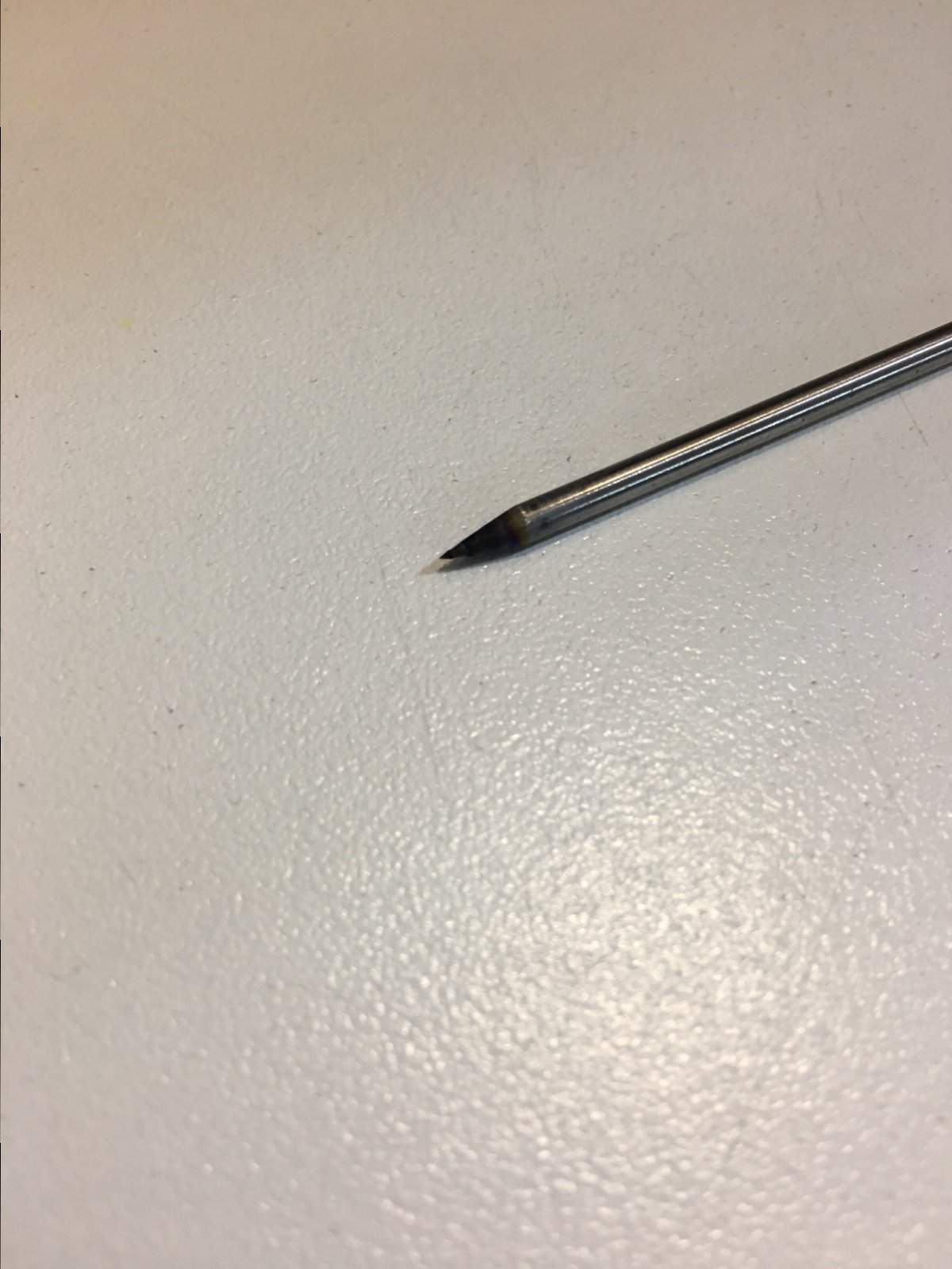

When I attempt to weld stainless (sharpened tip, not balled as I do for alu) I end up with the tip of the tungsten sooting back up about 6mm but the tungsten does not ball up or deform. Gas flow would be about 6 L/M though I've again tried more/less with similar results.

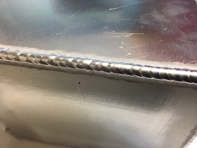

Below is a weld done before the reg change

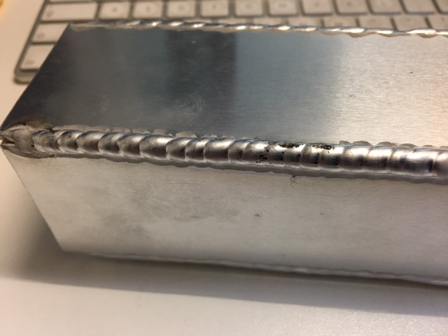

....and this is afterward.......notice the sooting at the start, not something I was experiencing before...
This is what the tip of the tungsten looks like when attempting to light up on stainless, even for only a second or two......
