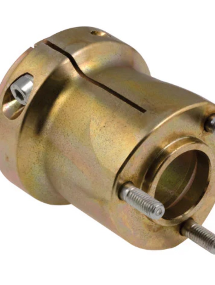

I haven't managed to find a section view of tony kart hubs but it looks like that space is occupied by the axle. I presume there is only quite limited material thickness on the end face to go at so not a lot of thread engagement. Certainly doesn't look like the 2xD you'd wantHow about drilling a fair bit deeper and using longer studs? Or against the rules?
I’d get hold of a scrap one and see how far you can drill before it breaks through to somewhere.I haven't managed to find a section view of tony kart hubs but it looks like that space is occupied by the axle. I presume there is only quite limited material thickness on the end face to go at so not a lot of thread engagement. Certainly doesn't look like the 2xD you'd want
The part is pretty similar to the below.
