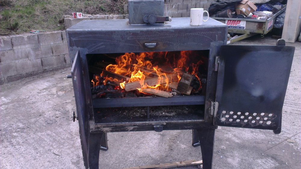

Again, doing things 'properly', and conforming to current regs, a 'tightness test' is part of the testing for all approved appliances. This is where all the rope seals come into play and do their part to stop any draw. I make the doors and ovens etc for a chap that makes masonry stoves- http://moslinstoves.co.uk/index.html although rare in this country they are excellent things, like a big wood fuelled storage heater. They must be completely sealed off as the idea is you burn them hard then shut them down to stop any draw cooling the brick and thus keeping them warm for as long as possible (24 hours or more).
The damper should never completely close in any design and a guide is to leave 5% of the chimney area open.
Would your wife like one of these in the house Snooper? I might be able to wangle you a deal...
