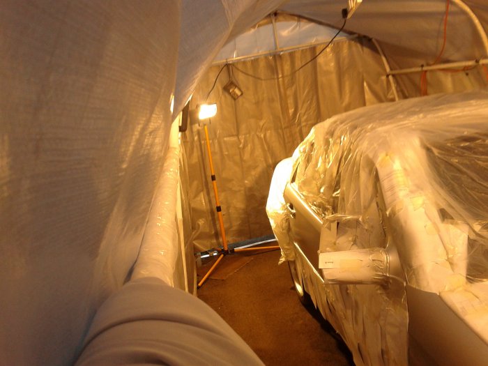

I'm going to paint my car with 2k, and as it seems the weather is never going to get any warmer, I need a way to heat the garage. Usually I just paint in the summer.
I'm planning on using a propane space heater to initially get the garage and the car metal super hot, then turn the heater off, turn the extractor on and paint. Once I've finished painting and all fumes have cleared, turn the spacer heater on again to bake the paint.
Only problem I've heard with propane is moisture. But if I have the extractor on at a very low speed while the heater is on (low speed so I don't suck all the heat out), will I eliminate any moisture problems?
The garage is just a brick garage with no insulation (no windows)
And yes I do have air fed for 2k
