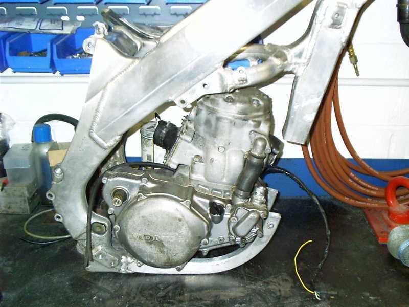

Can anyone shed any light on this for me, I have a CRF450 frame which is 6061 T6 which is being modified to fit a diferent engine.
This conversion means the frame is cut and extended and welded should the frame be heat treated to restore its strength. If so does anyone know where would do such an operation in the Newcastle area.
Many thanks.
