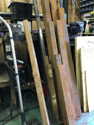

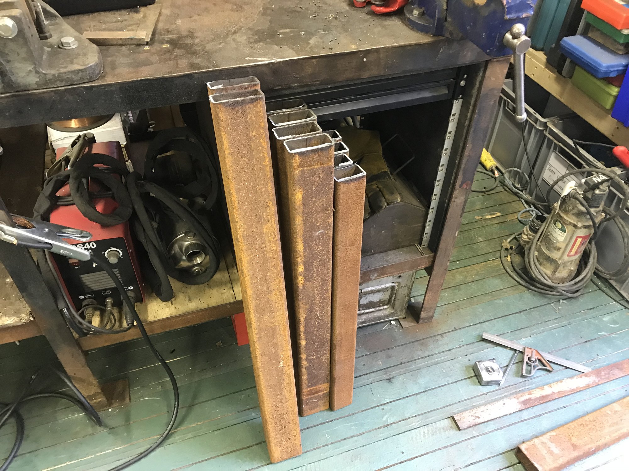

So, then plan is to build myself a pair of trestles, from steel offcuts I have laying around here. A quick rummage in the “new” stock turned up this little lot..
Some 60x40, 80x40 and 40x40.
I had planned on making them 1200 wide, but I have no tank big enough to de-rust them in, so 900 will have to do for now.

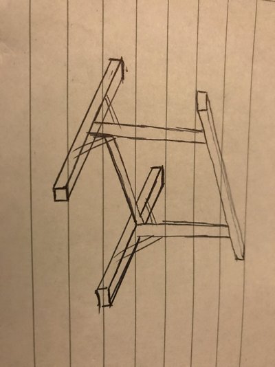

A quick sketch..
You get the idea. Need to measure the thickness of the forks at the farm, and leave the cross brace high enough so they can be chucked on the tractor, etc.

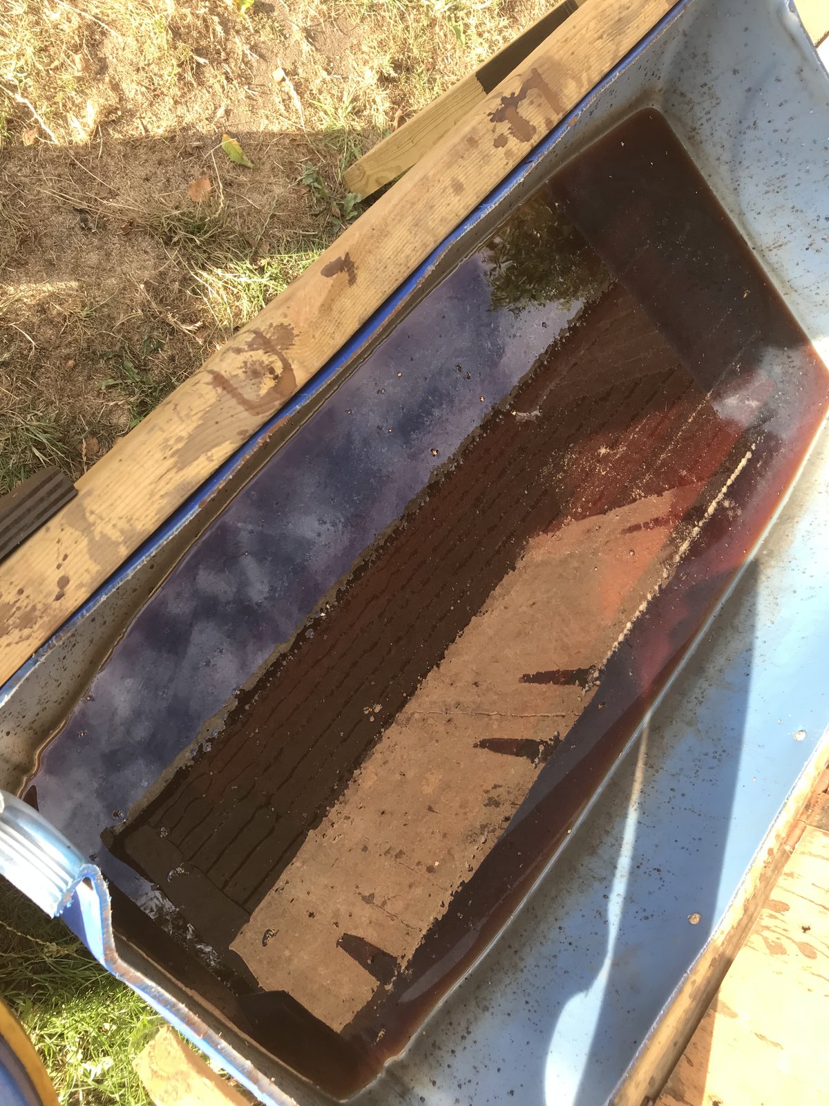

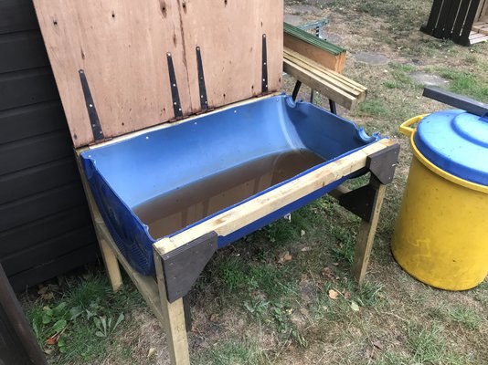

Now, time to build a tank to de-rust the steel in, and wipe Tosco and Morons our of white vinegar
