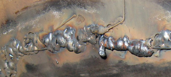

OK I'm fairly practiced, though not *that* experienced, with MIG welding. I've managed some lovely welds on 1.6mm bar, both butt and lap, and I've been practicing in the garage with sheets down to 0.7mm and managed just fine to lay some nice clean smooth welds (with the odd hole on the thin stuff, but I can quickly re-fill those with weld). I've arc welded 3mm+ beams, and have done some bodywork in the long distant past. I've used both a large industrial rig and my little migmate 130, and been fine. Until it matters! I moved to working on two large patches for my sills (700mmx75mm), and I've had a nightmare. The sill material is 0.9mm, the patch material is 1mm and sat in behind the hole in the sill so it forms a nice overlap inside which I'll drown in waxy mess when I've finished.
The problem - despite using the settings that work fine indoors on the same material, out on the car I seem to be getting either zero penetration or blowing massive holes out of the sill material. All of the settings seem to be wrong all of a sudden. I've ended up having to drop the current to stop eating my base material away and I've turned up the gas a little in case the very slight breeze is blowing it away - no luck. I'm laying down high seams which seem to be unwilling to shake hands between sides despite sub 1mm gaps. The best welds seem to be where I do have a large gap and have filled it, developing a nice hot spot, but I can't do that on the thin bits.
Any tips? I'm going to grind it all back and see how bad it is, then try again at the weekend! It seems solid, a good hard punch doesn't shift it, but I don't trust it and it's a mess.
