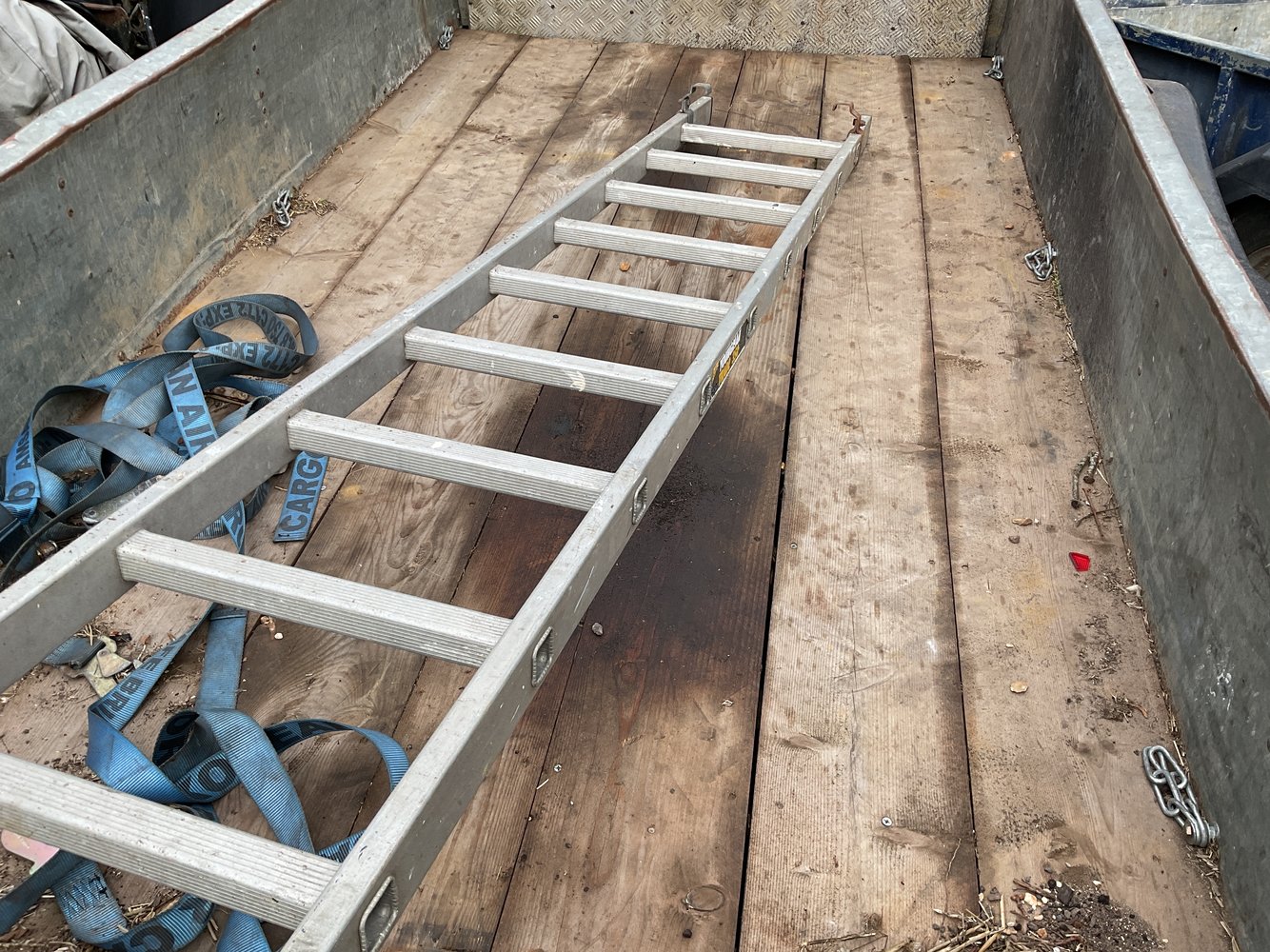

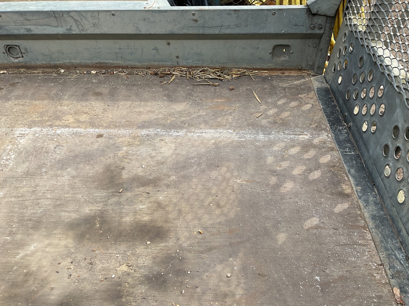

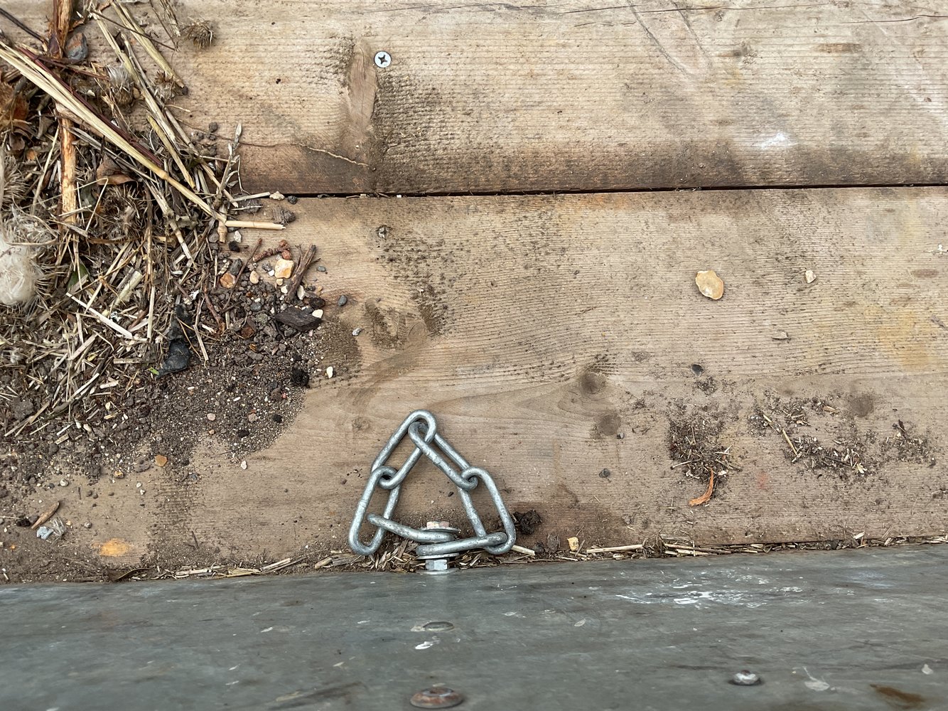

What is best way to fit stronger strap hooks down either side of dropside truck body
Not yet but soonNo, have you ?
drop sides have a habit of pulling in when you strap down and with drop down sides you dont get much pull down when your strapping down
best to have eyes within the drop down sides for better strapping down of items
That’s what I am thinkingWould any mods/additions need to be strength tested/certified by some 'trade' body?
Not if its not a hgv, strictly speaking yes, but who is going to inspect it?Would any mods/additions need to be strength tested/certified by some 'trade' body?

They are being attached to what again ?They are very careful with the description here Fred, not many of them carry a cert and at best are only as good as what they are bolted to. Of the eight of that type on my IW trailer I think only four haven’t been ripped out.
A truck bed's sheet metal.
It's up to the installer to "Make it right" and install to take the load to the frame.
An idiot can screw up anything.....![]()
It appears that one is located in the swing down side.Fred over here they call them lashing rings and rope hooks, only any goog legally for sheeting up. As @Pete. will tell you the police here can fine you for every one used to hold down a load .
does your trailers have bed eyes which are welded to the chassis on the trailer like the wagons do ?They are being attached to what again ?
My trailer does not, I have rub rails like on semi trailers. There are pockets for 2x4's, spaced 2' or so, and between them is 1/2" x 2" flat bar on edge, where I loop the chaindoes your trailers have bed eyes which are welded to the chassis on the trailer like the wagons do ?
we have the bed eyes as well on trailers there not just at the sides like the pic 8obs just posted up
Fred over here they call them lashing rings and rope hooks, only any good legally for sheeting up. As @Pete. will tell you the police here can fine you for every one used to hold down a load .
Some trailers have them, see them on dump trailers that also have slide out ramps.does your trailers have bed eyes which are welded to the chassis on the trailer like the wagons do ?
