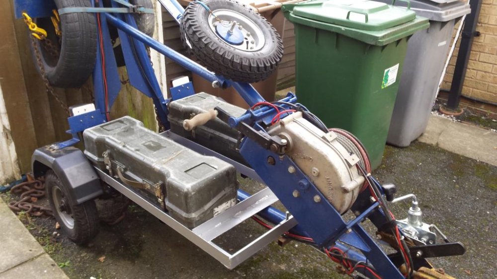

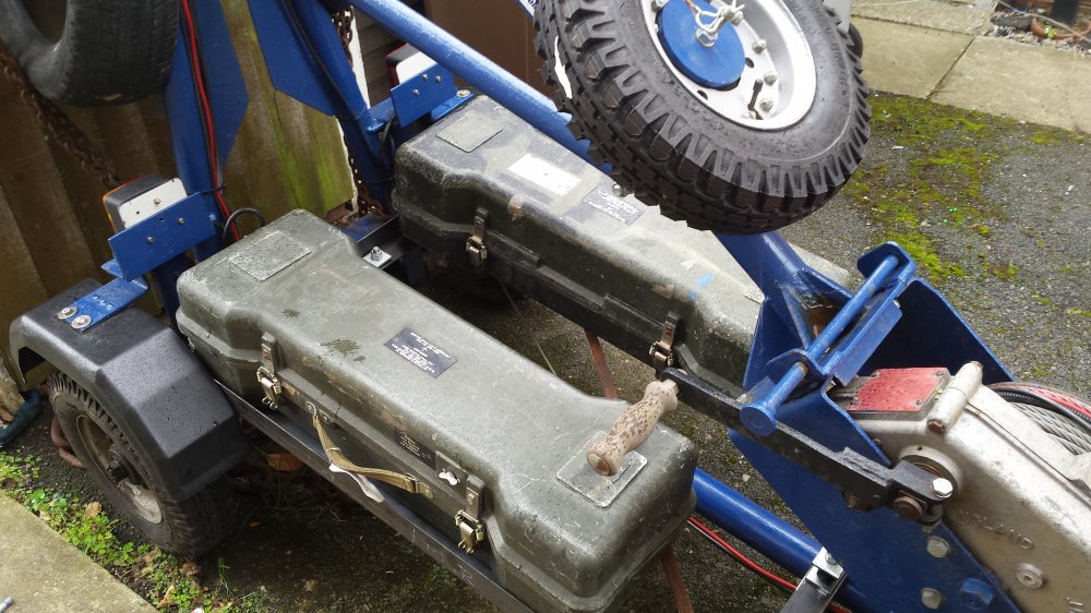

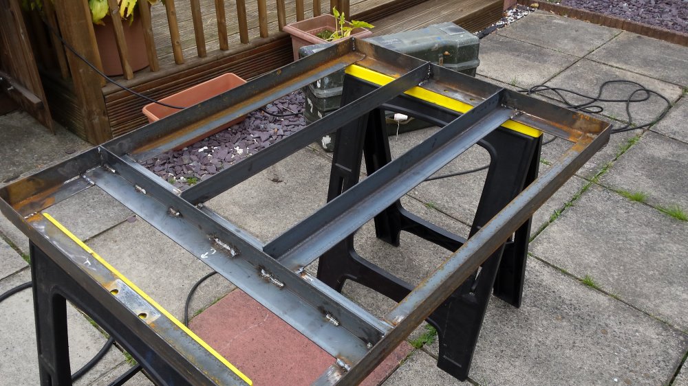

E excossack Member Messages 604 Location North West Sep 13, 2014 #1 Over the last weekend and today I have been making a tray to take two toolboxes or ex-mortar cases. Some pics. Test fit of the boxes on the frame Frame welded up 50x50mm 3mm angle and some 3mm flat bar. Mounted to the HF by u-bolts. Welded with a Cebora 130 with Co2

E excossack Member Messages 604 Location North West Sep 13, 2014 #3 It took a little bit of pondering after I purchased the cases. I can get a 2t trolley jack, sledgehammer etc in the cases Chains etc are always welcome addition as spares.. If you want to pm me with some details if you don't mind?

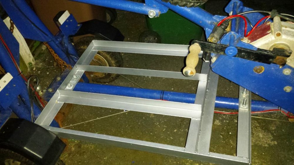

E excossack Member Messages 604 Location North West Oct 2, 2014 #6 No real update on this other than, the frame is painted silver and attached to the crane.
E excossack Member Messages 604 Location North West Oct 2, 2014 #7 Here is the picture of the frame painted
E excossack Member Messages 604 Location North West Oct 13, 2014 #8 Finished. Paint and boxes bolted down.
