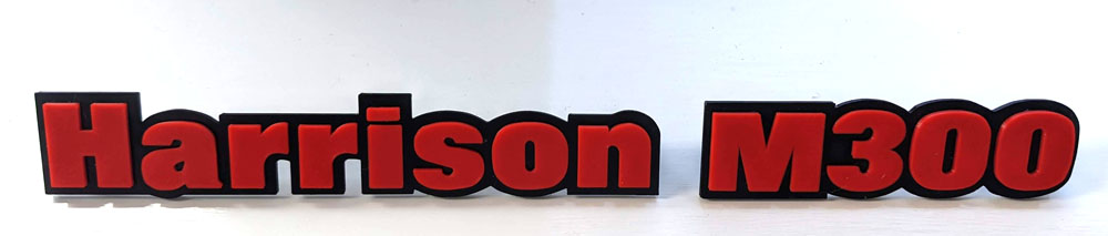

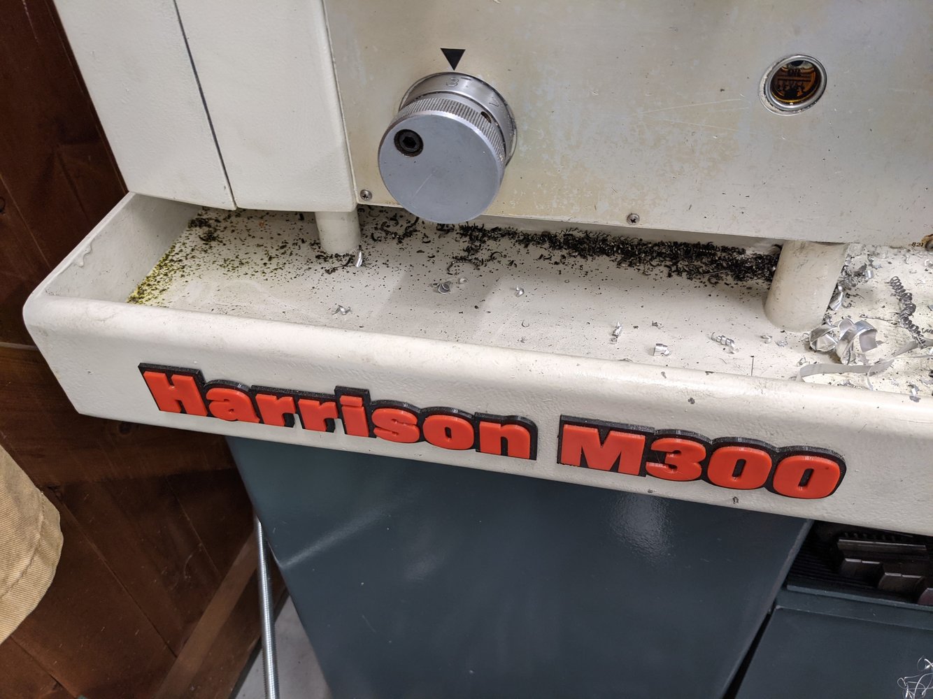

I posted here a couple of years ago about the refurb of my M300. As part of the refurb I remade Harrison M300 badges, someone on the Harrison mailing list asked me last week if I could make him a set, so I decided to do a small run.

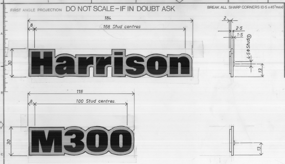

I recreated a 3d model of the name badges from the Harrison drawing.

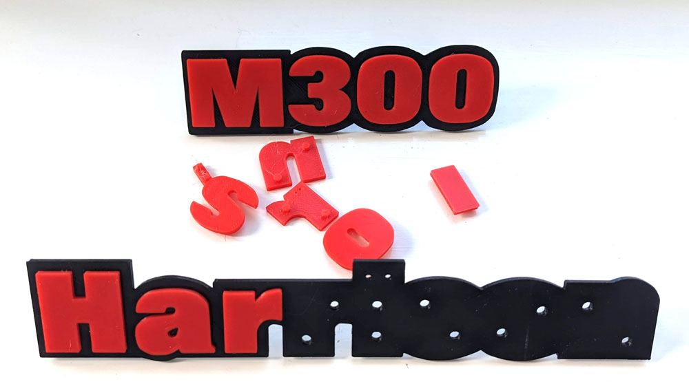

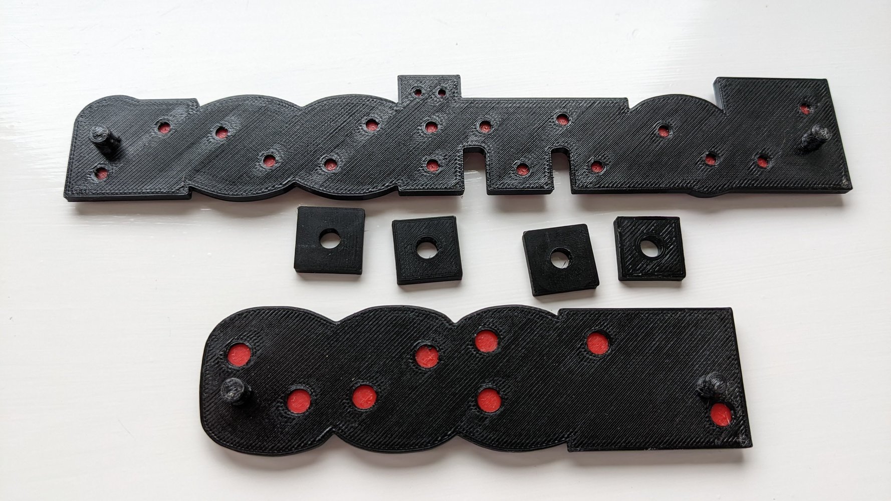

I don't really want to make huge quantities, this certainly isn't a commercial venture, just an enthusiast with a 3d printer. The background is printed in black PETG, the letters in red PLA (probably a bit brighter red than the "Poppy Red" called out on the Harrison drawing.
