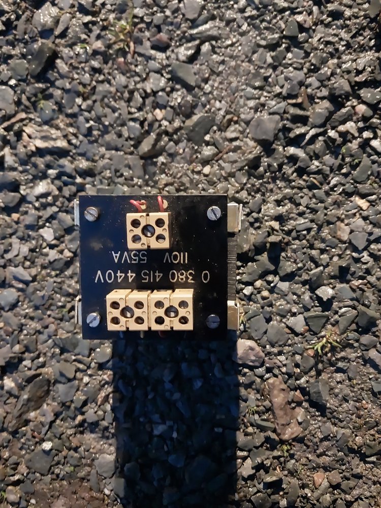

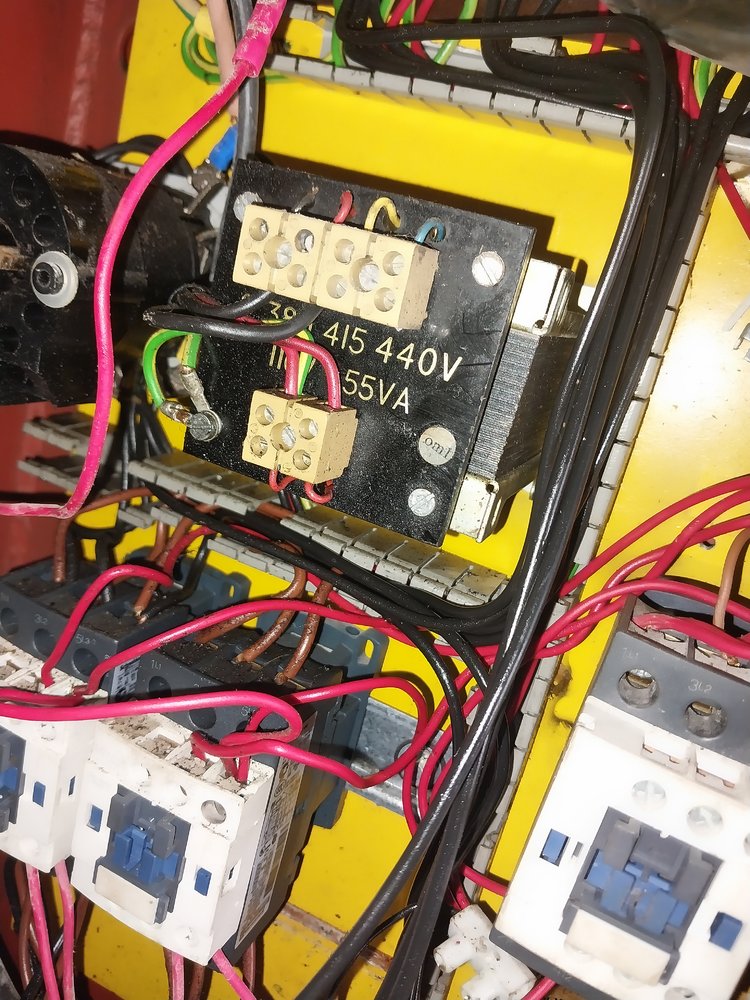

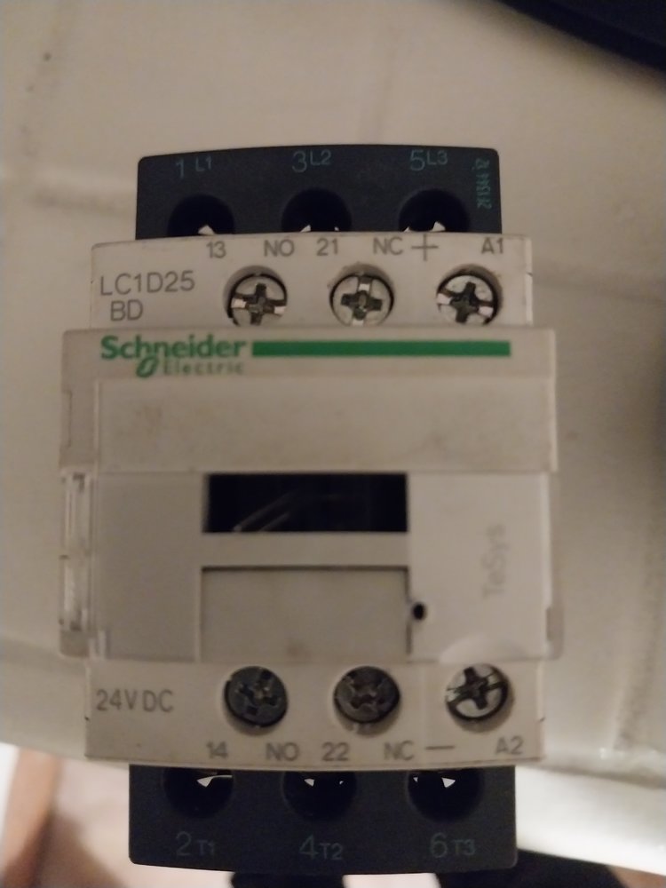

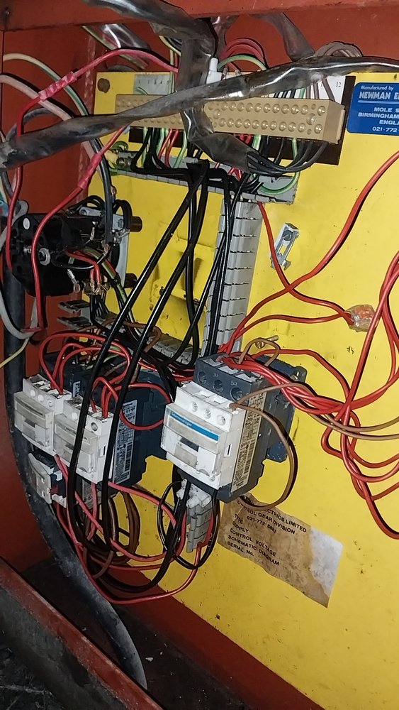

Hi Guys. I bought a harrison m300 lathe .I had it running on a static converter and it never ran right. I now have a 3 phase generator but i heard a poof after running the lathe for a few minutes and the motor no longer works and the contol contactor does not go in any more.. I pressed in the forward and reverse contactors in manually and the motor runs just fine . but the control lever activating the switches don't spin the motor. ALso I tried pressing in the control contactor and pressing the switches and no joy... I did notice that the control voltage supplying the contactors are pictured below and are 24v dc coil contactors.. I presume they should be ac 110 v contactors.. Does anyone know or have an original un tampered with harrison m300 lathe or pictures of the electrical panel and contactors so I could see what was orignally in the machine so I can restore it to its original state
Thank you
ps i have the transformer removed as i want to get it tested to see if it works or not
