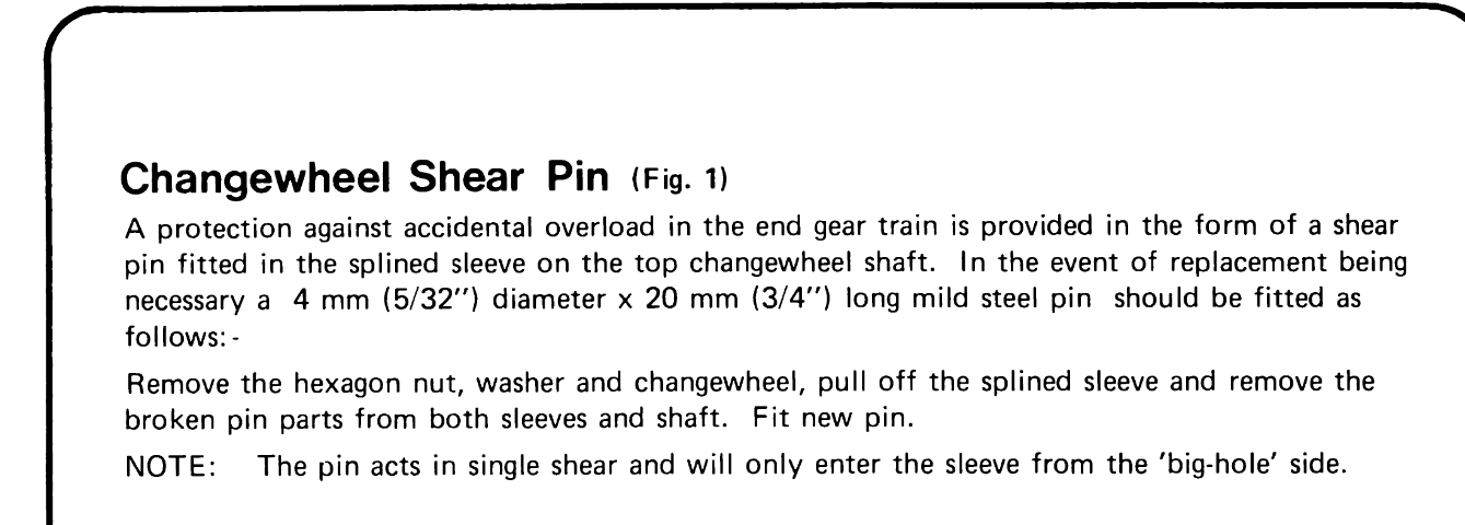

I foolishly drove my carriage into the carriage stop while screw cutting
. Now the Lead screw is not rotating, the feedrod is still rotating.
If I grab the leadscrew it can be freely rotated by hand
Is there a shear pin?
