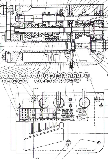

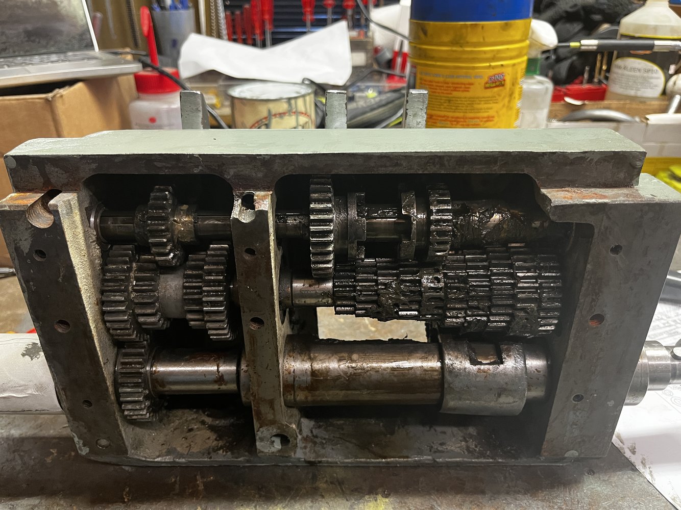

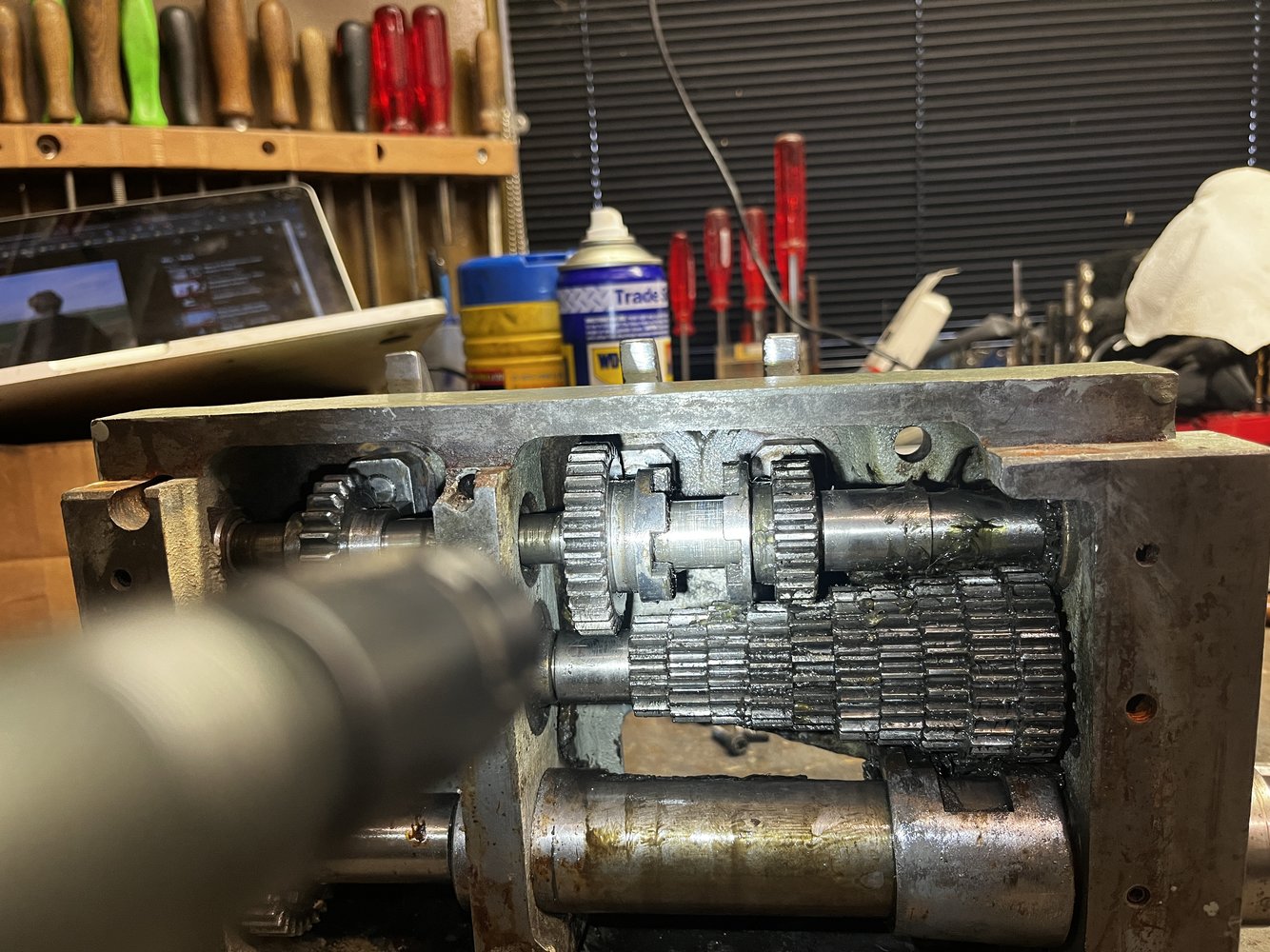

Hello,
I'm just in the process of stripping and rebuilding my new (old) L5 11".
I have the all metric screw cutting box (3 knobs) and have removed the selector knobs to clean & repaint. On assembly i noted that the selector shafts dont have flats, so i'm not sure as to the position of the knobs. I've tried with everything as per the parts drawing from the manual (below) i.e knobs vertical and gears as shown. But that doesnt seem right.
Would anyone know the correct setup? Or be able to remove their box and take a pic? (how mine is now below)
