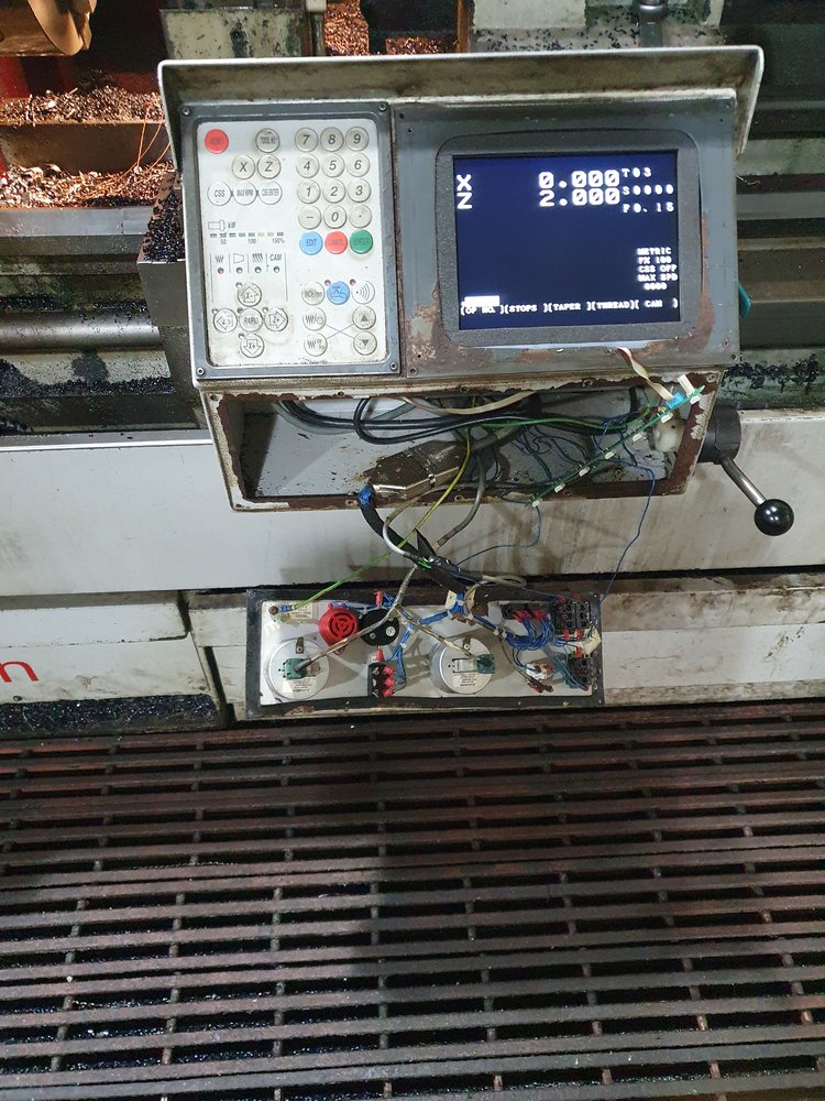

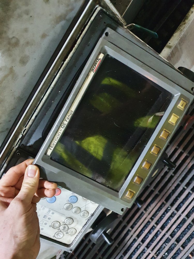

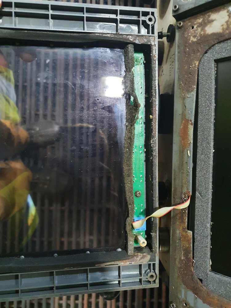

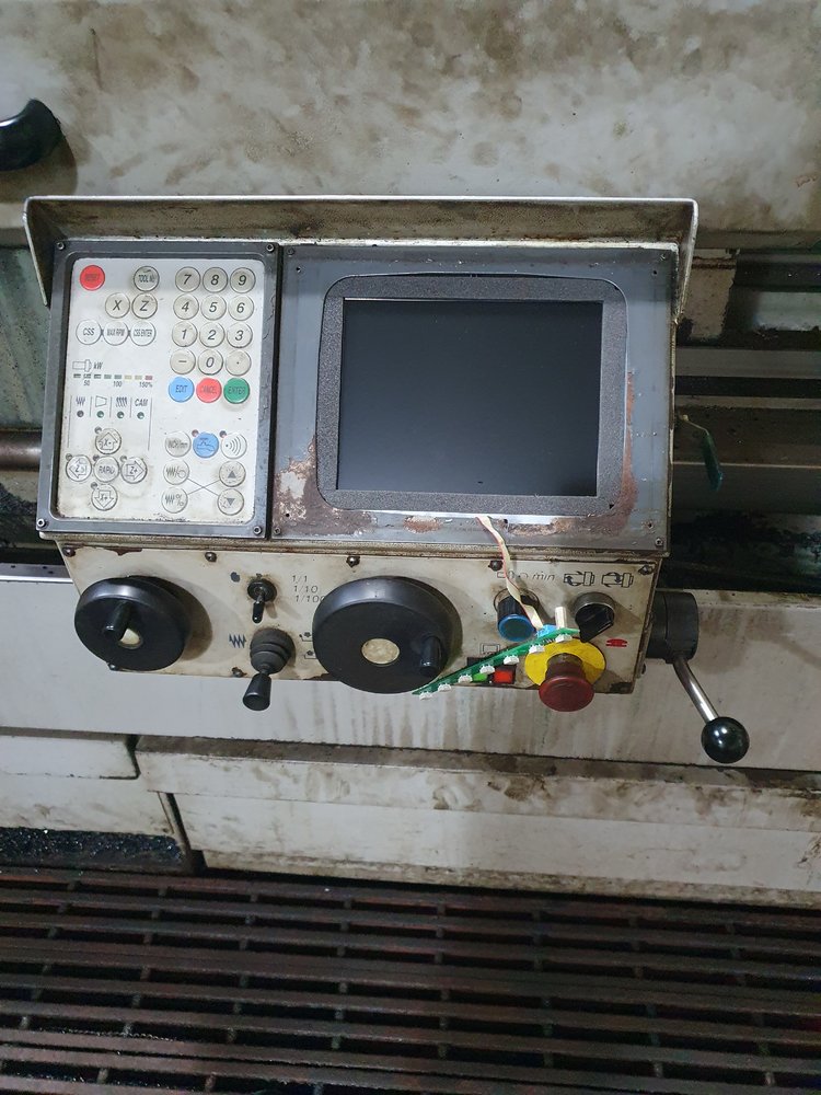

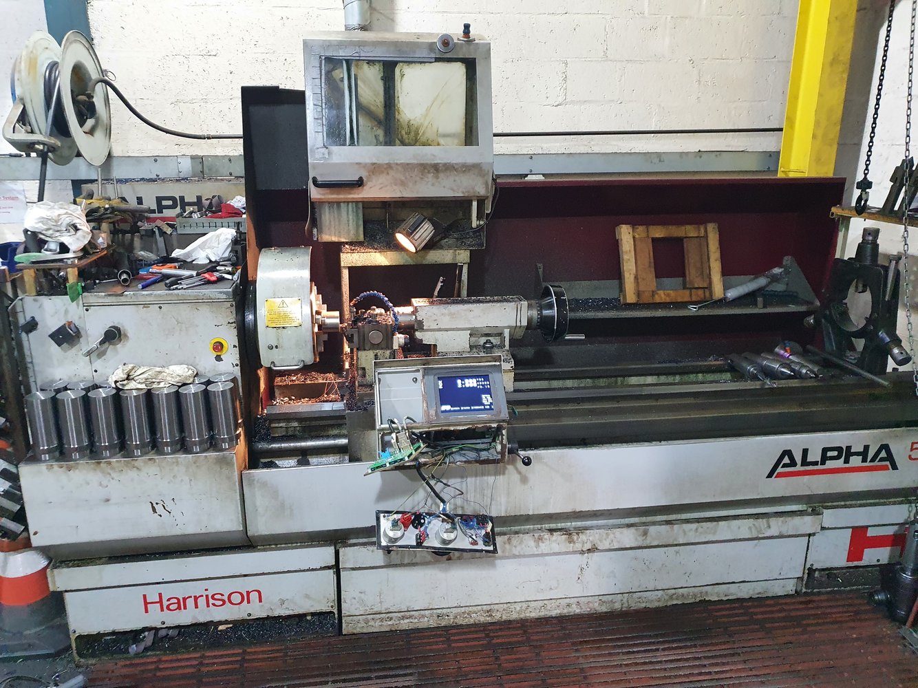

Anyone know of a company that specialises in fixing these machines. Or what might be wrong the screen push buttons have stopped working. Press and nothing happens, have had the circuit board out and it checks out all connections are in good condition and resistance checking of the cables and switches has proved they are all OK along with the ribbon data cable. Starting to suspect the main computer as there is also problems programing the X and Z axis with it completely dropping the inputs ounce finished programming and having to start again.
