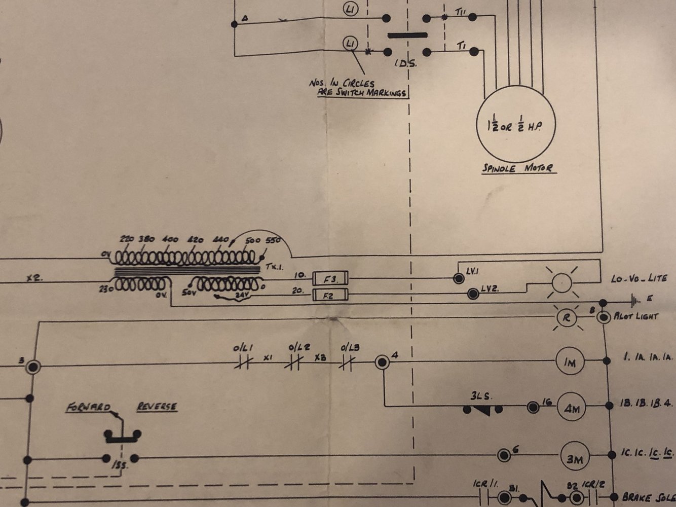

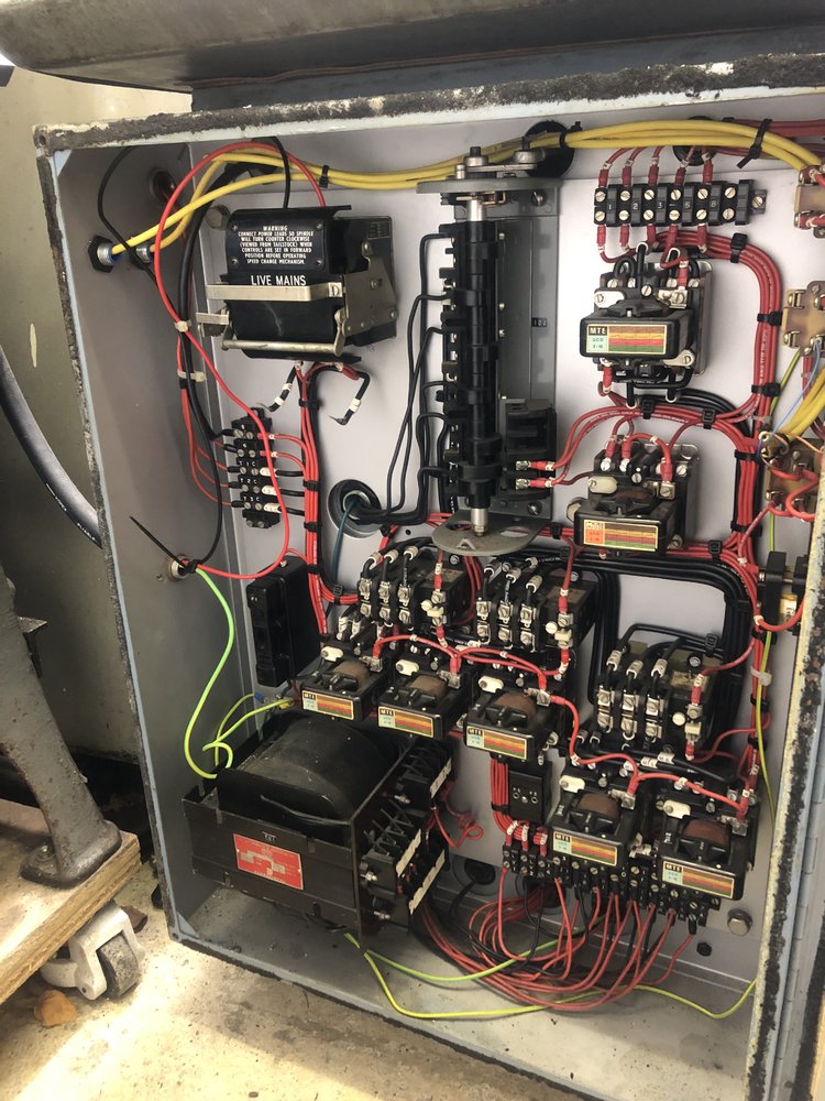

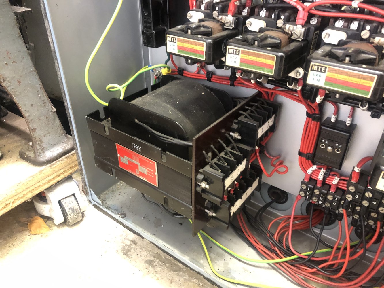

I've been playing with the electrics on the Hardinge today. I wanted to check that the control circuit was working OK. The control circuit is 230V AC, this is normally supplied by two of the phase connected to the primary side of a transformer and the 230V comes from the secondary. My initial plan was to disconnect the secondary and wire this directly to a 240V supply. Problem is the 0V on the secondary is tied directly to earth. I swapped the input to the primary to the 220V input just to check things were OK but I was rather hoping to take the transformer out of the circuit. Don't really know enough about these things to know if its wise or safe to remove the link between the 0V on the secondary and earth then feed mains directly into the control circuit, hoping someone on here has done it before or knows enough about these things to help out.
