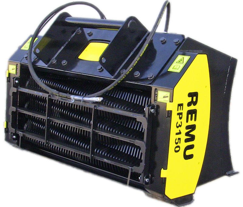

Hi guys, I need to do some (a lot) hardfacing on a remu screening bucket, can anyone suggest what hardfacing wire to use please ? I am using it in my Lorch m pro 252
Lots available, Esab OK Autrod 13.91, Lincoln LNM 420FM. Ask at your local welding shop, they will probably have some other (cheaper) makes. Don't expect any of it to run/weld nice, and don't worry about spatter, just blast it on.
