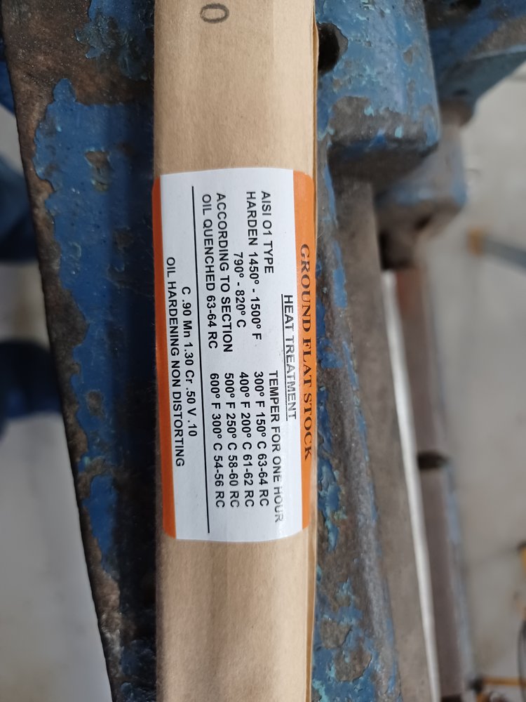

I have made a louvre press and also the louvre die (from tool steel) but im assuming i will need to harden the die? It will have to shear/cut the metal as opposed to me slitting the metal first.
Anyone got any tips on the process of hardening (and tempering?).
Thanks
