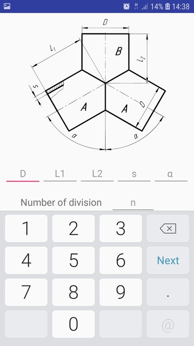

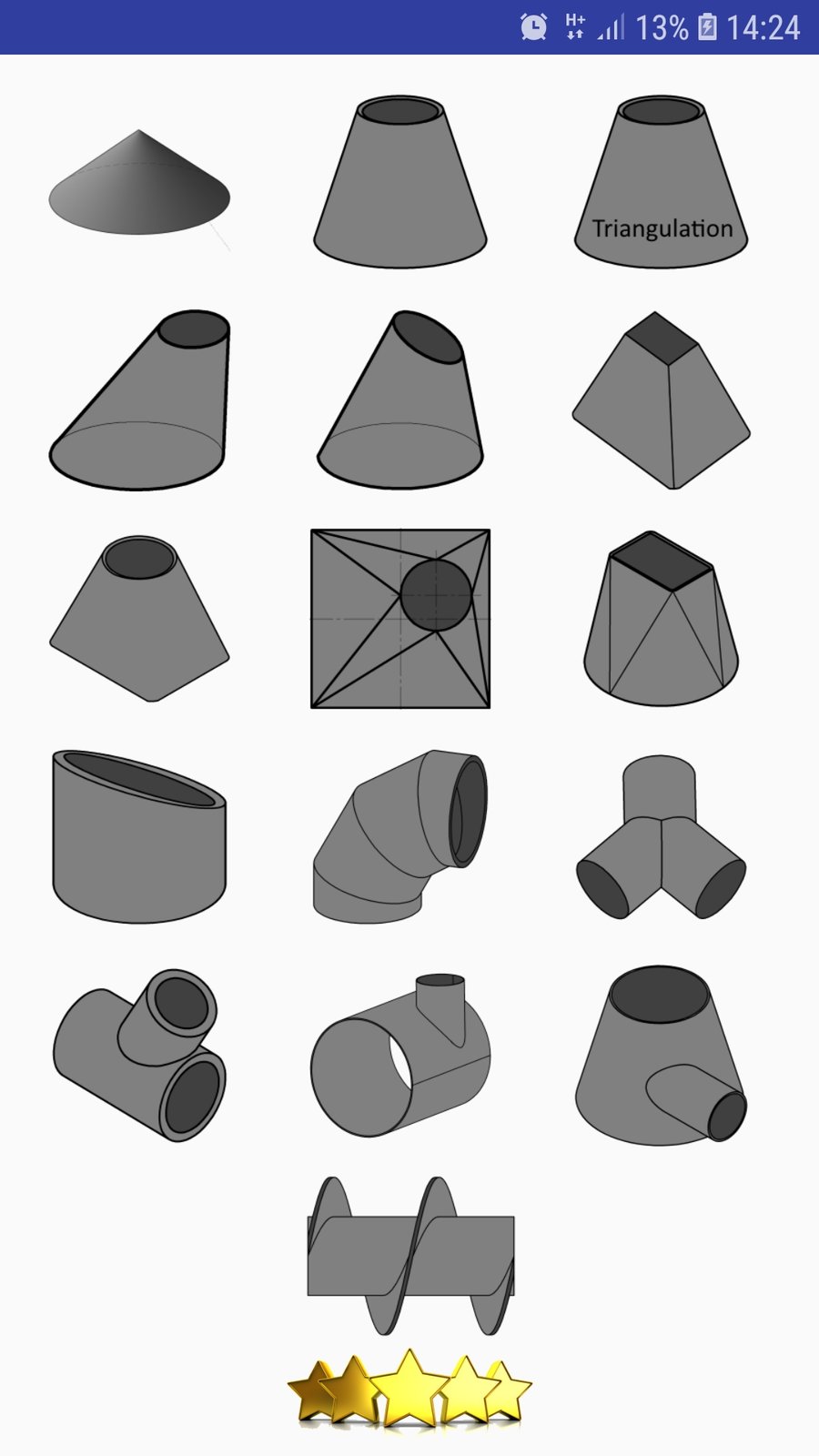

I downloaded an app called flat pattern a while back and it's a really handy app so I thought I'd share it here. It helps for making templates for sheet work.
This is the home screen showing the different shapes and pieces it can calculate.

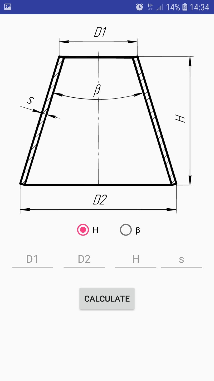

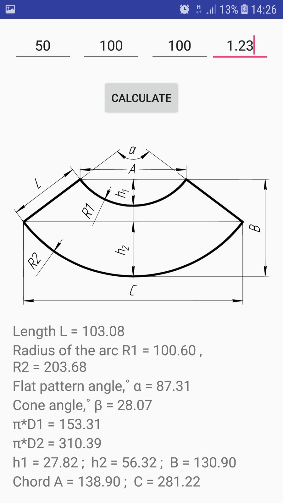

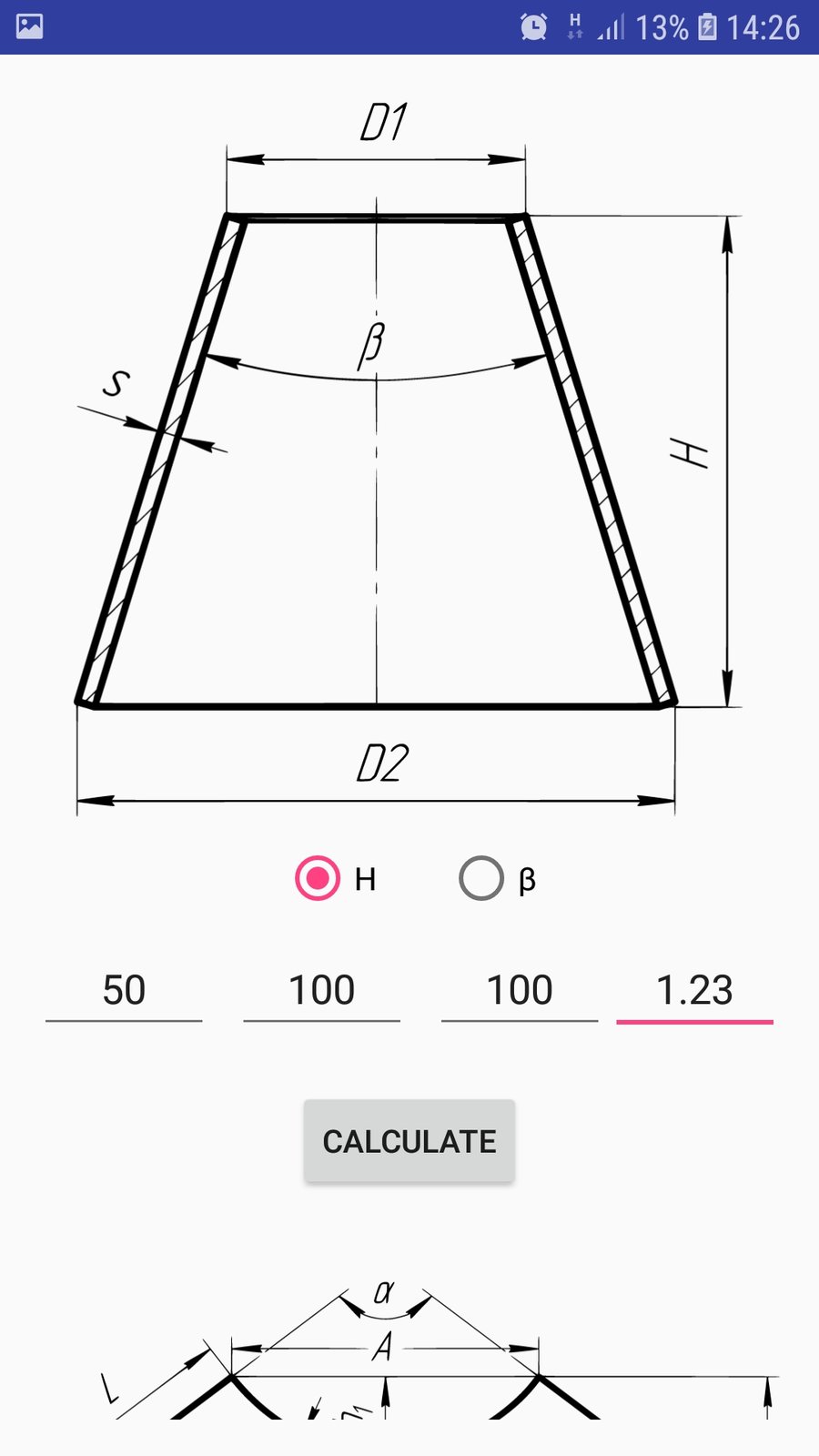

This is how to make a cone.

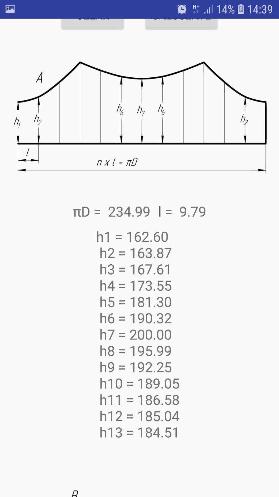

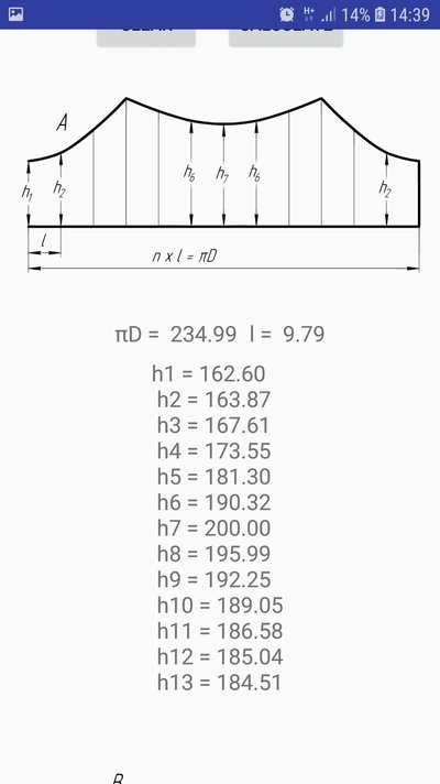

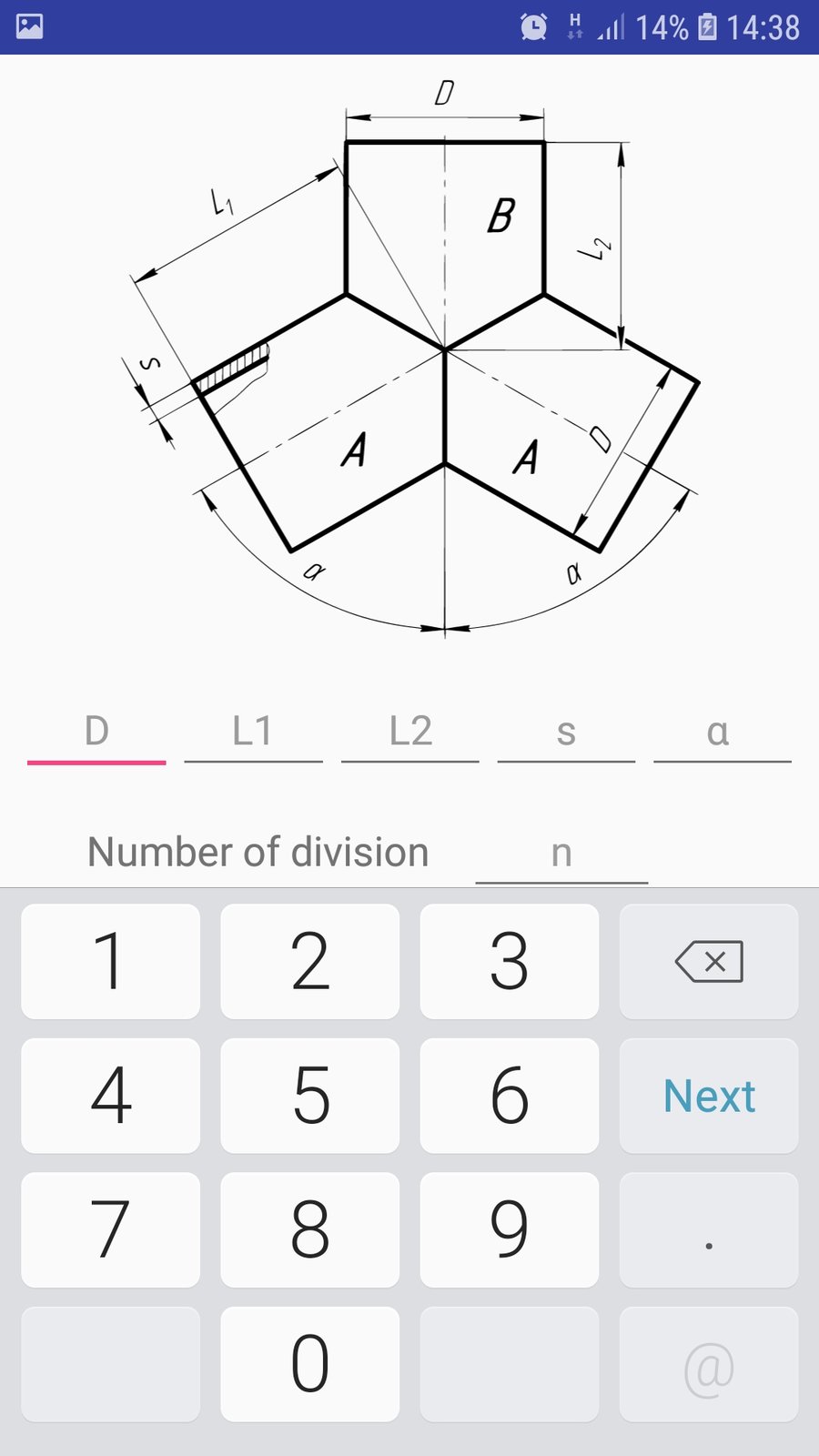

Just fill in your dimensions and hit calculate.
