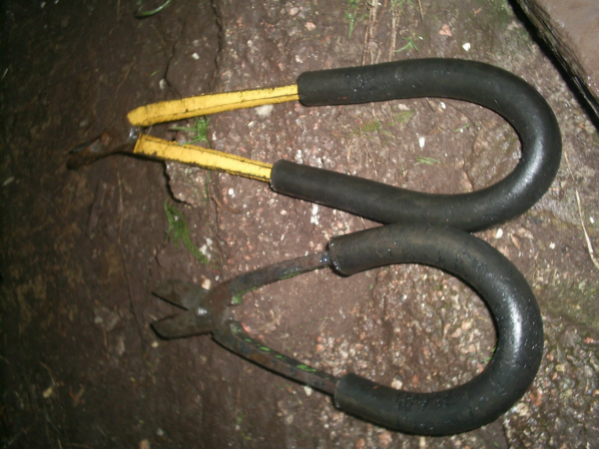

P p0689109 Member Messages 1,954 Location stoke on trent,england Mar 28, 2017 #1 Picked these up from a boot sale Sunday. I was only going to copy the hose trick but for £4 the pair it would have been rude not to have them. I think the hose is a brilliant idea used as a return spring.
Migmac Forum Supporter Messages 9,038 Location Kintyre. Scotland Mar 28, 2017 #2 Handy for hanging them up too
Swift&Bold Member Messages 987 Location Dan Saff! Mar 28, 2017 #3 .....and it stops you getting pinched by the ends of the arms....great idea!

L lexi Member Messages 1,638 Mar 28, 2017 #5 Gonna show my age. I first saw that over 40 yrs ago. Old Plasterers trick for tin snips to cut the Blakey beads.
