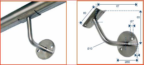

Mild Steel handrail brackets - the weld-on type with a round backplate for screw fixing to the wall.
Whats the minimum clearance between the face of the wall and the back of the tube. Building Regs not giving me any minimum dims - around 80 - 85mm i think.
Anyone know of a site etc to get some dimensions for these handrail brackets?
Bit of a brainteaser getting your head round the measurements on that pic! I take it it's saying the centreline is 67mm from the wall.
I think you've probably hit the nail on the head!
