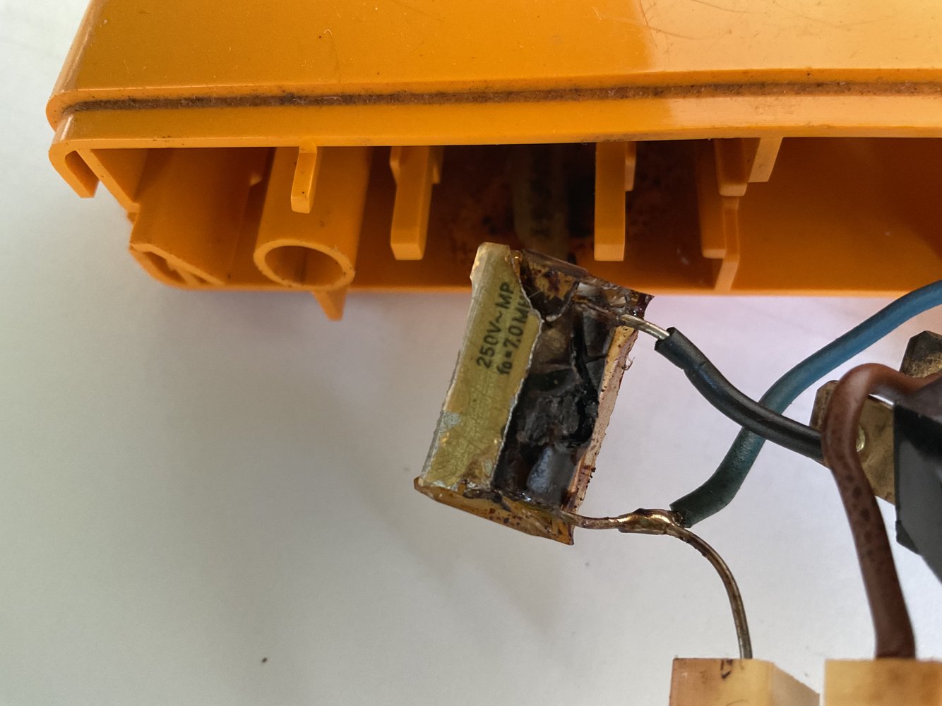

You can cut it out, but DO NOT JOIN THE ENDS.Does that mean I can disconnect it and join the wiring together?
She also tells me tingling feelings around the moulding joint.
yep just loose it its only a supressorLooks like some sort of suppression capacitor.
Ive been known to, umm, remove them completely.
And then wonder why the DAB radio, or any numbe of other wireless thingies, don't work properly, and the motor brushes wear out double quick.yep just loose it its only a supressor![]()
how many times do you dry your hair with all those gadgets running at onceAnd then wonder why the DAB radio, or any numbe of other wireless thingies, don't work properly, and the motor brushes wear out double quick.
