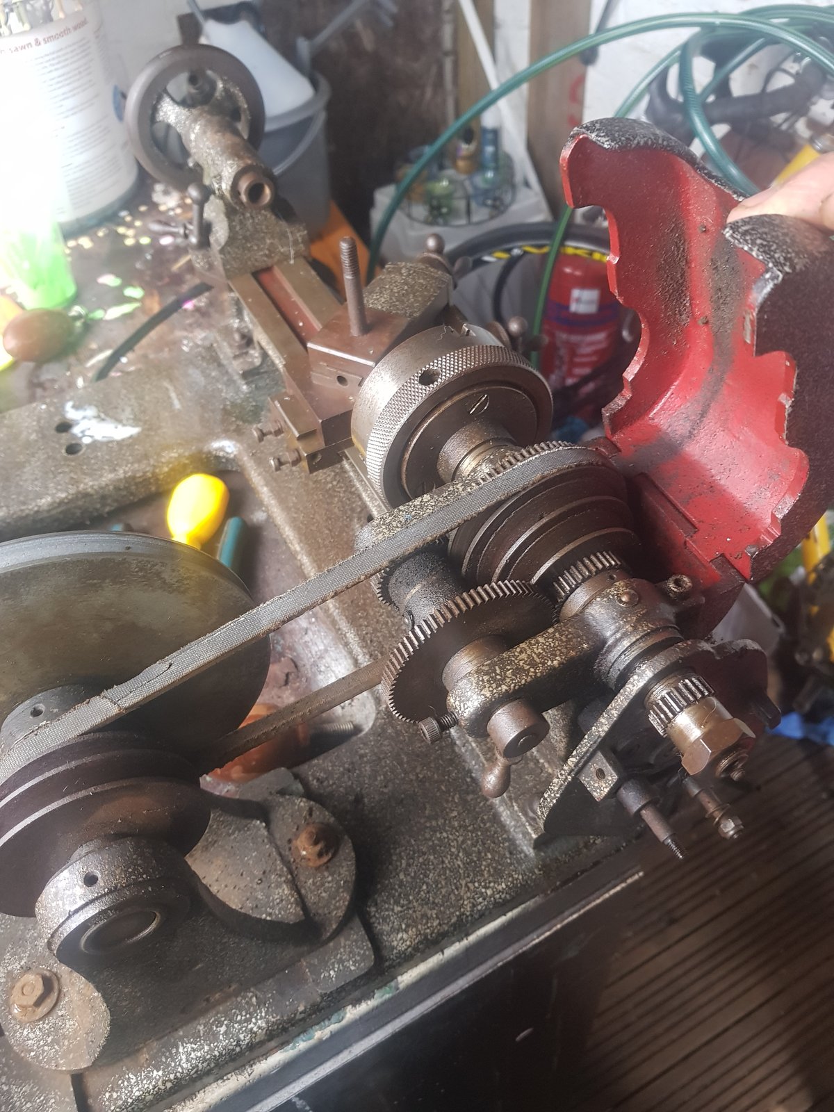

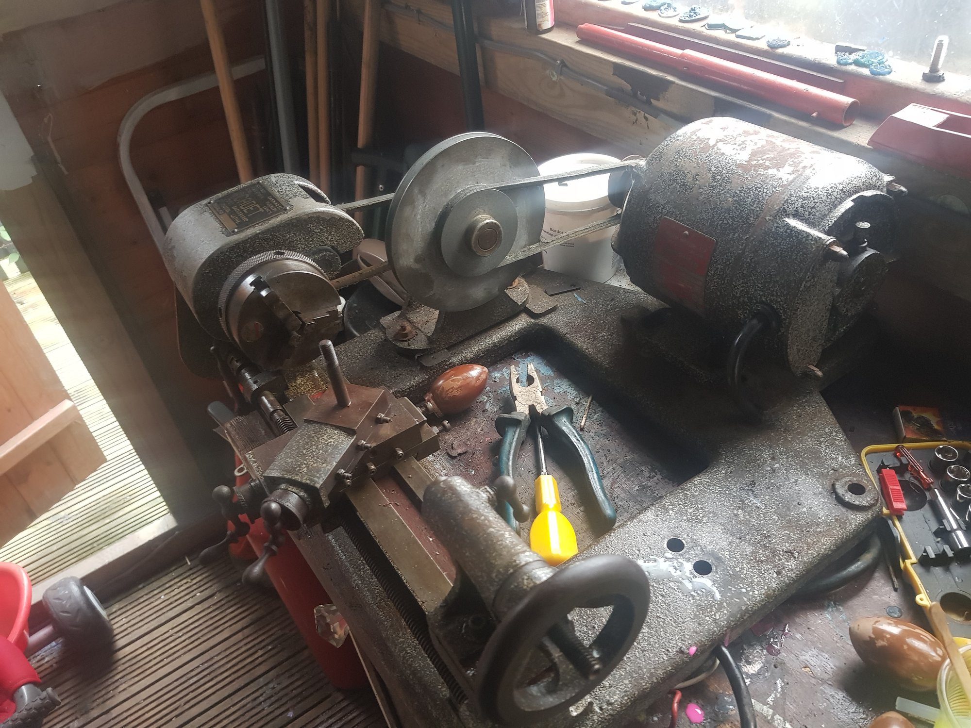

So i just got myself a tiny haighton cader 2.5" lathe.

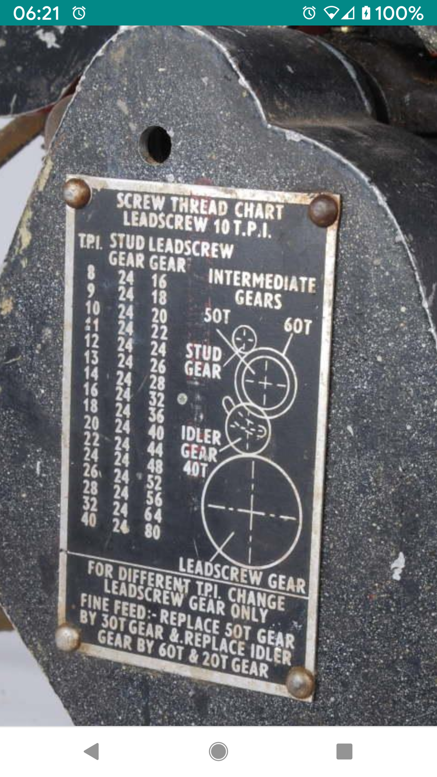

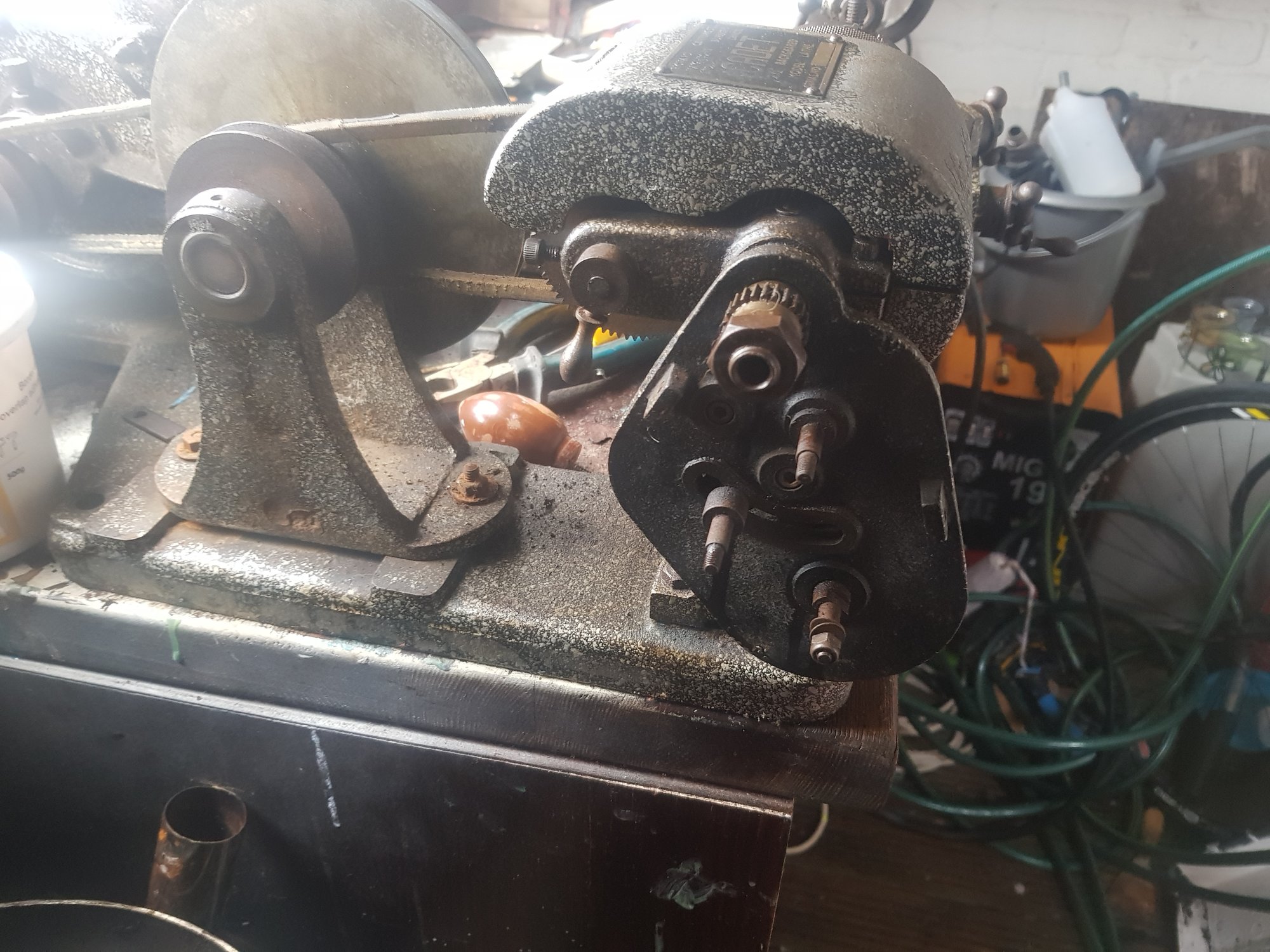

It runs and there doesn't seem to be much play in any of the axis. However it is missing all of the back gears and its tool post. Tool posts that will fit I've seen on Amazon and I wouldn't even now where to look for the back gears.
Any ideas please
